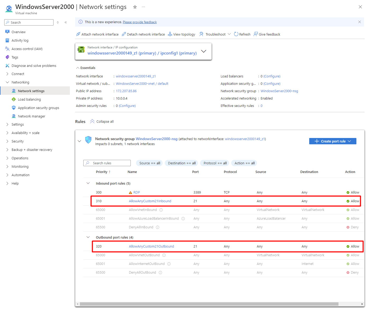

- On Azure Network Security Group (NSG) Configuration, allow port 21 and passive mode ports.

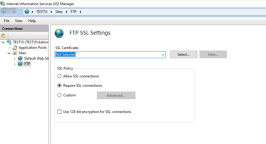

- Also, in IIS FTP Configuration you will need to configure passive mode with the correct port range and public IP.

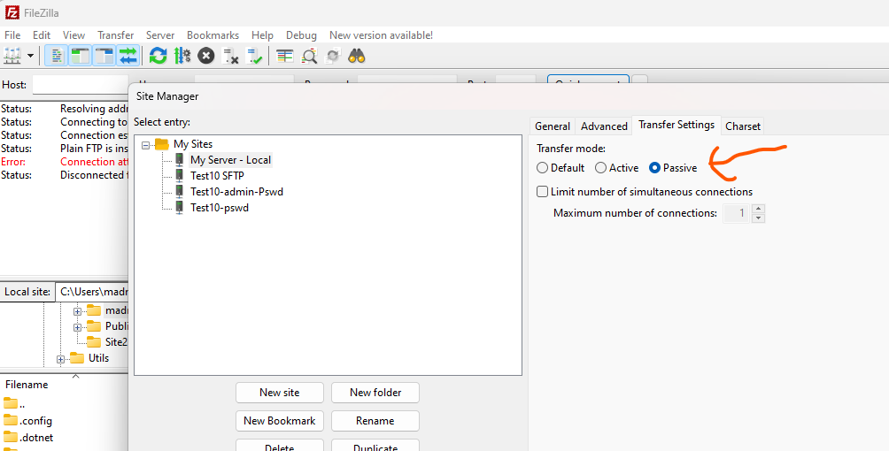

- In your FTP Client you will need to set it, so that it can use passive mode.
