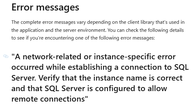

    Hi @Vinith,
    Thank you for reaching out and welcome to Microsoft Q&A.
    The error message means the client cannot connect to SQL Server over the network.
    Could specific SQL Server configurations contribute to sporadic connectivity problems, and if so, which settings should I review?
    Here is a known issue like yours and this article is the official document, you can follow steps to troubleshoot your issue.
    Are there any known issues with ODBC Driver 17 for SQL Server that might cause such problems, and would updating the driver potentially help?
    I've checked the list of bugs fixed in ODBC. I don't find the same issue. However, keep the latest update is always good to avoid some unnecessary issues.
    In addition, you can also try to use the Product Key in the SQL Server 2019 installation center Maintenance - Version Upgrade. There was a customer had the same issue before and he resolve it by this method, maybe you can try this.
