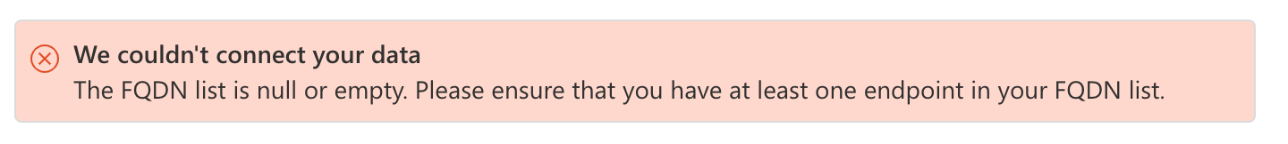

Hello, I have set up an Azure OpenAI and Search setup according to https://learn.microsoft.com/en-us/azure/ai-services/openai/how-to/use-your-data-securely , which uses private endpoints. The validation script in that link passes, and I can use this setup to successfully use the chat playground in OpenAI Studio (Accessing OpenAI over the private endpoint works). However, when I try to use "Bring your own data" the ingest job fails, with the following error in OpenAI Studio:
error
I do have records in private DNS zones attached to the same vnet which resolve the search and blob services.
Using chrome devtools, I can see that the URL it is hitting for this API call is like the following (I have anonymized all resource names)
https://openai-627ef756872.openai.azure.com/openai/ingestion/jobs/test?api-version=2024-05-01-preview
and the body it is sending is like the JSON I will paste at the bottom. Using this same, or similar body, I can replicate the problem using an api call using curl or az rest, and get the following response: {"error":{"code":"BadRequest","message":"The FQDN list is null or empty. Please ensure that you have at least one endpoint in your FQDN list."}}
Here is my sample request body which produces the error. What could be causing this? All devices I have tested on do have VPN connectivity to the private endpoints and can reach them. I have tried many variations on the body and headers, but have found no solution. Notably I have also tried using the "privatelink" DNS addresses of the blob and search services in the body, such as testsearch788726557.privatelink.search.windows.net but this does not help.
