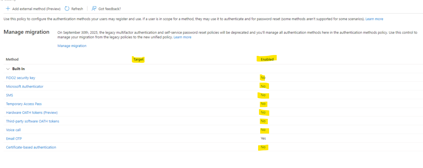

    1. We checked modern authentication methods in your tenant to verify if any groups were added to the authentication method policies as per the above cause. However, we observed that no methods were enabled, and no groups were added to any of the policies. Please refer to the screenshot below.

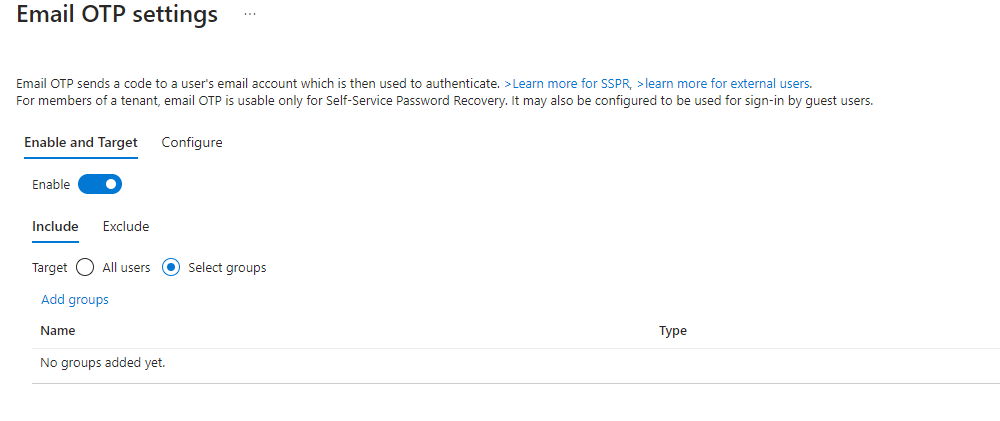

    I note that the one policy which is applied is set to selected groups yet no ground selected.
    Could this be the issue?

    I note that the one policy which is applied is set to selected groups yet no ground selected. Could this be the issue?
    No, I believe that one policy is an email OTP authentication method policy. If no group is selected in email OTP policy will not create this kind of issue. You can ignore that even if it is enabled.

    To get more clarity regarding your auth method policies, could you please provide a screenshot of your modern authentication methods policy?
