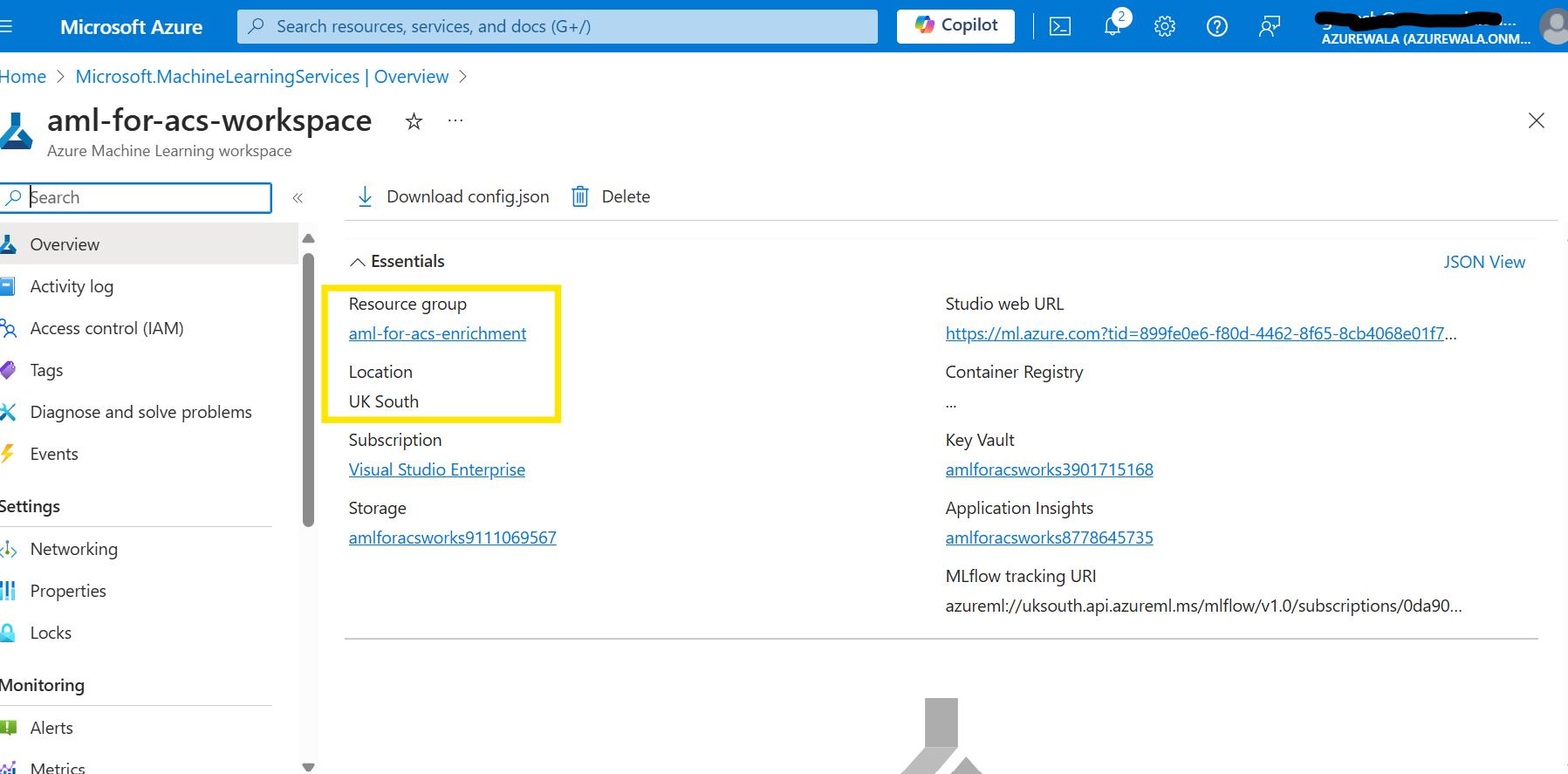

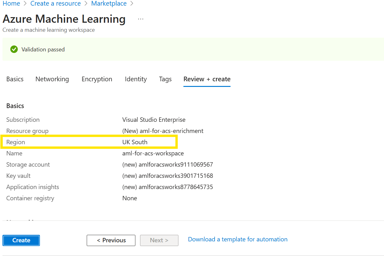

Throughout the exercise, I created all the necessary resources exclusively in the South UK region. I have successfully completed multiple steps, and all my resources are currently in this region. However, at the step "Create an Azure AI Search resource", I can now not create the Azure AI Search resource because the UK South region is currently unavailable 'due to high demand'.
The exercise requires that all resources be in the same region. As a result, I cannot proceed with or complete the exercise due to the unavailability of the UK South region. Restarting the entire exercise in a different region is not feasible because of the significant progress already made.

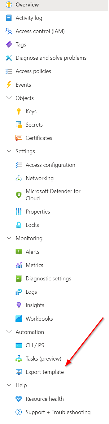

    Here's what I'd do. Recreate all resource in the new region, however this can be somewhat sped up by going to each resource. Under 'Automation' you should find 'Export template':
    Once the template is generated, copy the template out into an editor such as VSCode, locate the 'location' parameter and amend it to your new region, for example notice the 'location' param value below for a Key Vault (example):

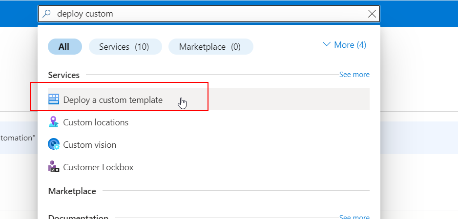

    Once amended to the new region, search for 'Deploy a custom template' in the Azure Portal:

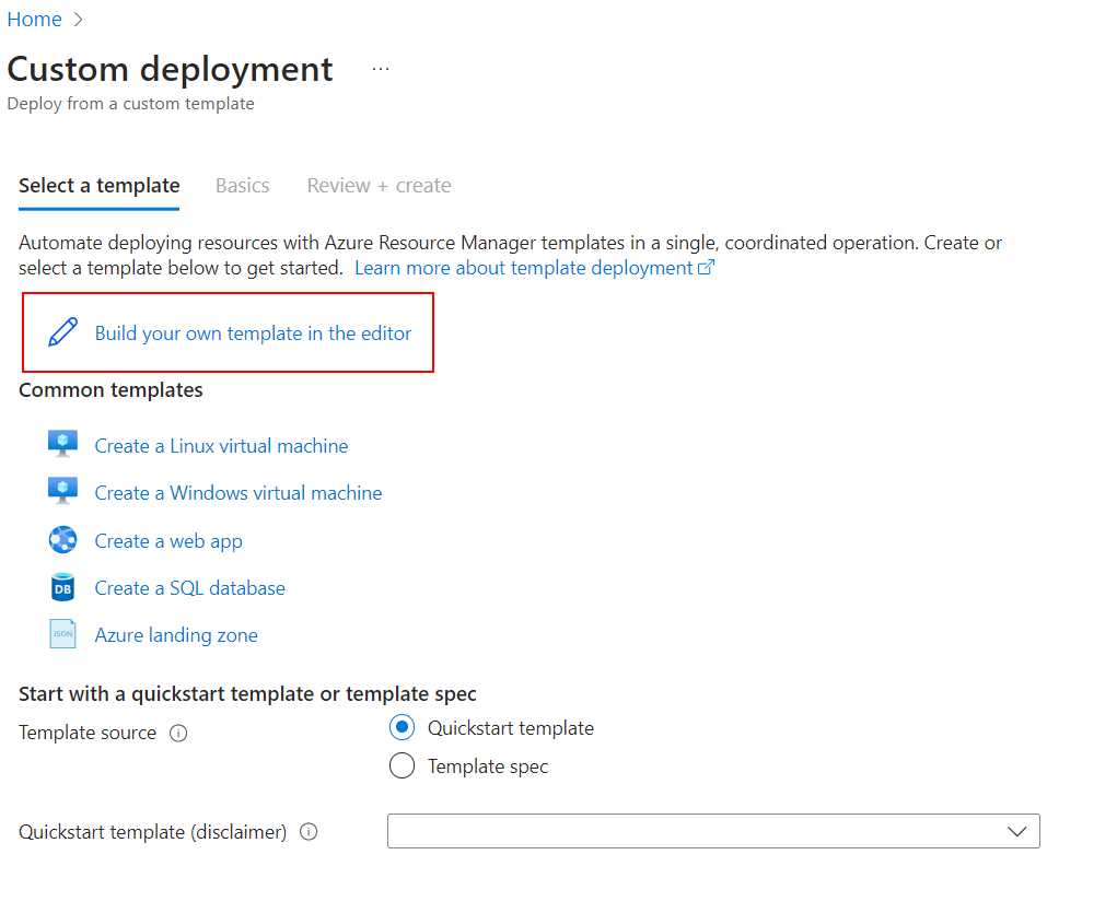

    Select 'Build your own template in the editor' and then paste your new modified template here.
    Then save & deploy this. It will redeploy your resources to the new region, using the existing settings from the current region. Note, this won't do data plane actions, so anything configured from an application point of view won't remain. Although there should be ways you can 'export' and 'import' those too.

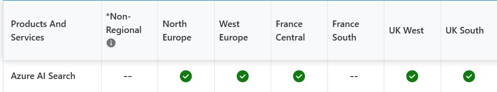

    We had tried from our end and the UK South region is enabled to us as shown in below screenshots:
    01
    02
    Due to high demand some of the regions was unavailable at that moment, the regions will enable automatically in sometime. Meanwhile please try to clear all the cache files and cookies from your browser and try accessing again the resource.
