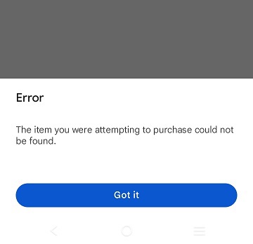

I am getting below exception when I try to pay for a subscription for play store.
Plugin.InAppBilling.InAppBillingPurchaseException: Unable to process purchase. at Plugin.InAppBilling.InAppBillingImplementation.ParseBillingResult(BillingResult result, Boolean ignoreInvalidProducts) at Plugin.InAppBilling.InAppBillingImplementation.PurchaseAsync(String productSku, String itemType, String obfuscatedAccountId, String obfuscatedProfileId, String subOfferToken) at Plugin.InAppBilling.InAppBillingImplementation.PurchaseAsync(String productId, ItemType itemType, String obfuscatedAccountId, String obfuscatedProfileId, String subOfferToken)
Screenshot:
Screenshot_20240612_201556
I have created 3 subscriptions on the play store and activated it. My app was in draft state, so I published a new build on internal testing. But when I try to pay for the subscription I am getting above exception.

Do I miss any other set up for the proper working of this? Is the subscriptions needs to published on anywhere? I have activated it. And my app is not published yet, it is only in draft state.

    2024-06-14T05:45:45.93+00:00
    Did you have accepted the test program invitation in the google play console? If not, please refer to these steps to enable the test program invitation
