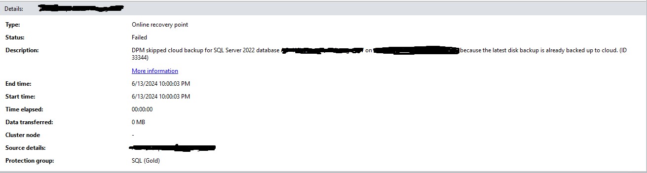

All of our online recovery points within Azure Backup Server on prem have been failing recently.
The description of the failed job is as follows: DPM skipped cloud backup for <DatasourceType> <DatasourceName> on <ServerName> because the latest disk backup is already backed up to cloud. (ID 33344)
To me this is very strange behaviour as the recovery points (local disk back-ups) are running just fine.
It seems to me that MABS is not recognizing any changes within the local back-ups compared to the back-ups in Azure.
When I run a consistency check on these back-ups and manually run an online recovery point back-up, the online recovery back-up will run succesfully.
Am I missing anything here or might this be a bug?
We are currently running MABS on version 14.0.46.0.
Any help would be greatly appreciated.

  1. Radu 0 Reputation points
    2024-06-24T07:24:39.1733333+00:00
    The "operation failed. (ID 120002)" issue ended up resolving itself after a few hours.
    The eventual solution to my main issue seemed to have been the fact that I changed the schedule of the local disk back-up (recovery point) from every 2 hours to every 4 hours.
    After this change my online recovery points have been a lot more consistent.
