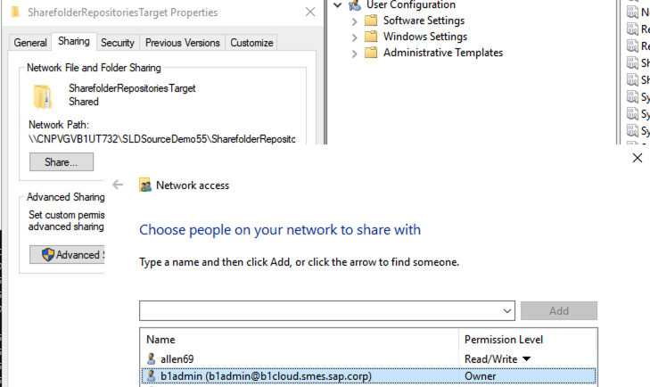

I have a Windows Server 2019 machine, this machine is in a domain system. I shared a folder on this machine to a domain user,

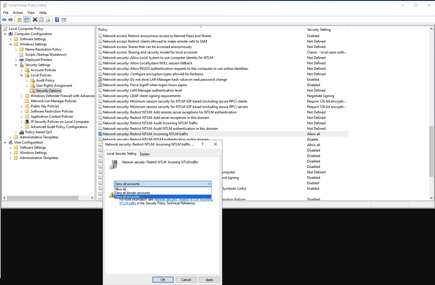

then I logon another machine with this domain user and can access the shared folder successfully, but if I disable the incoming NTLM traffic of the shared folder machineUser's image

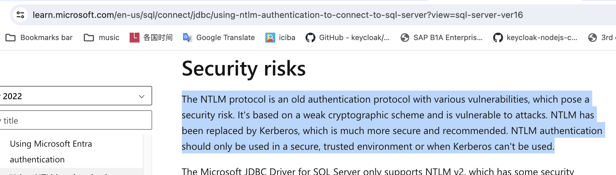

Then I can access the shared folder from anther machine with that domain user again, so I guess the NTLM authentication protocol is used for the Windows folder sharing, is this true? If it is true, is it possible to force the Windows folder sharing to use Kerberos authentication? Because from this document I know NTLM is an old protocol and not secure enough. User's image

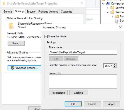

    Hello Gong, Allen, you're correct that when sharing folders in Windows, the default authentication protocol is NTLM. However, it's possible to force Kerberos authentication for folder sharing. To do so, verify that DNS is correctly configured for the domain and ensure that the client and the server clocks are synchronized. Use FQDN for both the machines and avoid IP addresses. Enable "Require Kerberos" in the Advanced Sharing settings of the shared folder and ensure that the client machine also supports Kerberos. If all the conditions are met, Kerberos will be preferred for authentication.

    Yes, you’re correct. The NTLM (NT LAN Manager) authentication protocol is indeed used for Windows folder sharing. NTLM is a challenge-response authentication protocol that proves to a server or domain controller that a user knows the password associated with an account. It’s still supported and must be used for Windows authentication with systems configured as a member of a workgroup.
    However, in an Active Directory domain, Kerberos is the default authentication protocol. If the Kerberos protocol isn’t negotiated for some reason, Active Directory uses LM, NTLM, or NTLM version 2 (NTLMv2).
