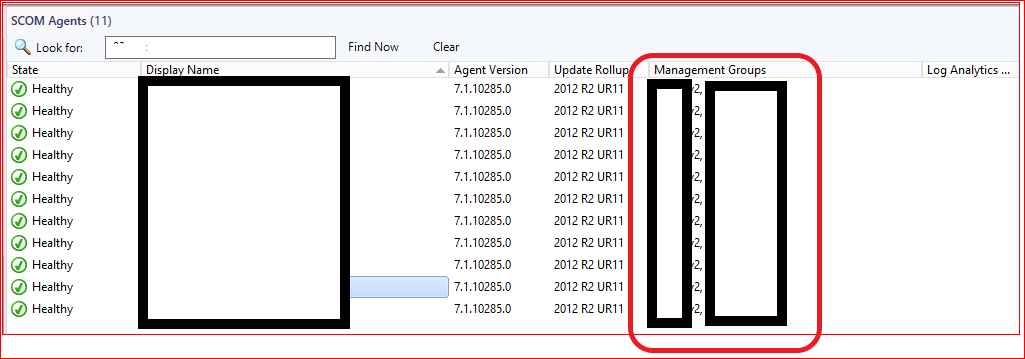

Have found a bunch of servers that have not reported in SCOM2019. Have double checked SCOM2012R2 and can confirm that both Mgmt Groups are shown on the SCOM Management>SCOM Agent console view:
multihome

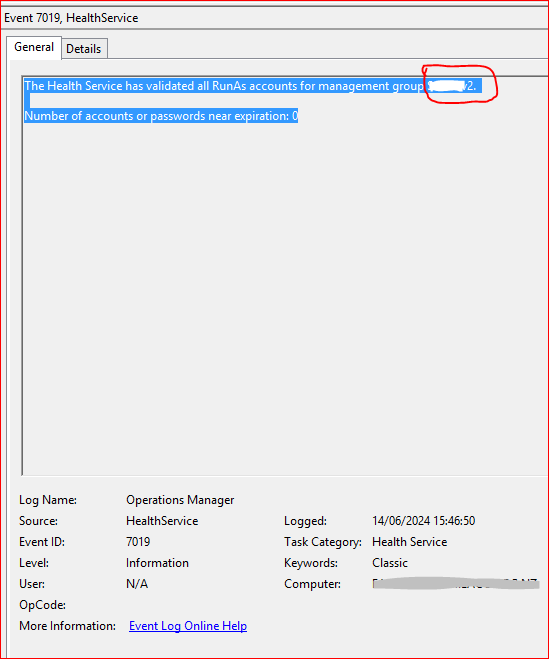

Have confirmed that both Mgmt Groups are present in Servers Control Panel>Microsoft Monitoring Agent window. Have Flushed the Agent and can see in Event Log that HealthService is validating RunAs accounts from SCOM 2019:
event log

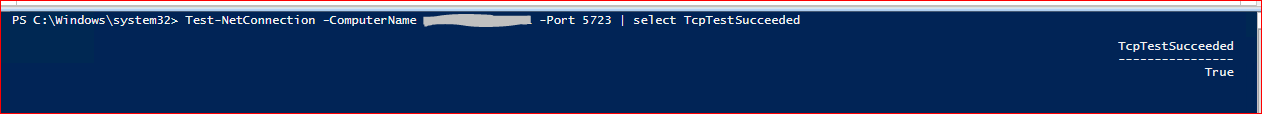

    The Test-NetConnection cmdlet is a powerful command used in PowerShell to test the network connection on a system. It can be used to diagnose network connectivity issues and to provide information about the network connection status on the host that runs the command.
    Here’s a basic example of how to use it:
    Test-NetConnection -ComputerName GatewayServer.contoso.com
    You can also specify a port with the -Port parameter. For example:
    Test-NetConnection -ComputerName GatewayServer.contoso.com -Port 5723
