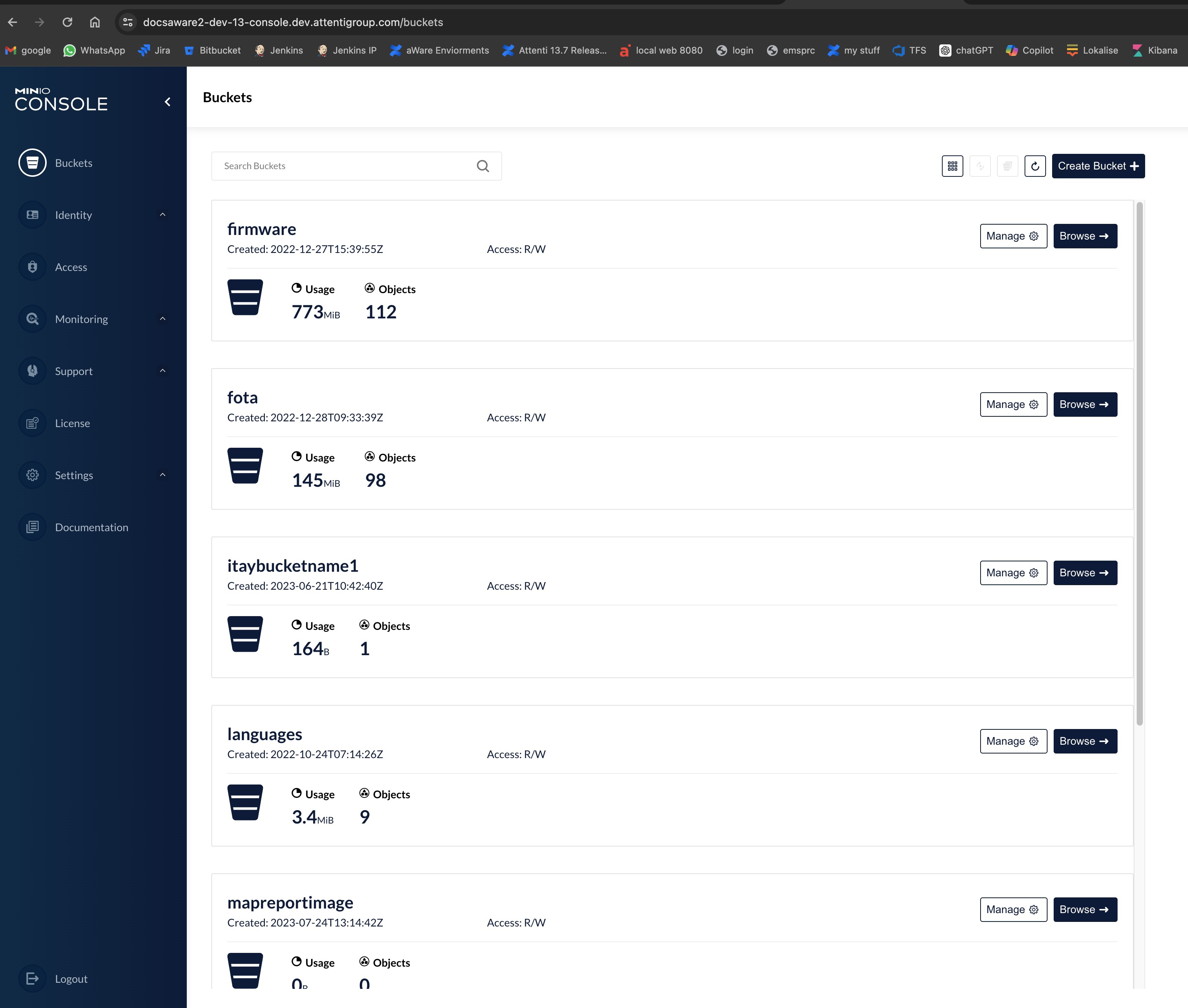

screen shot of the MinIO web interface attached
appriciate your help here
Nachum
The Working MinIO Web Interface
working site
The not working MinIO web interface

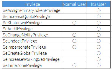

  1. KOZ6.0 6,735 Reputation points
    2024-06-16T18:18:34.1466667+00:00
    Has the issue been resolved?
    User have various 'privileges'.IIS user have more privileges than normal mode user.
    タイトルなし
    The MinIO interface probably requires some of these privileges.
    I think that running Visual Studio in administrator mode will enable debugging with IIS Express.
