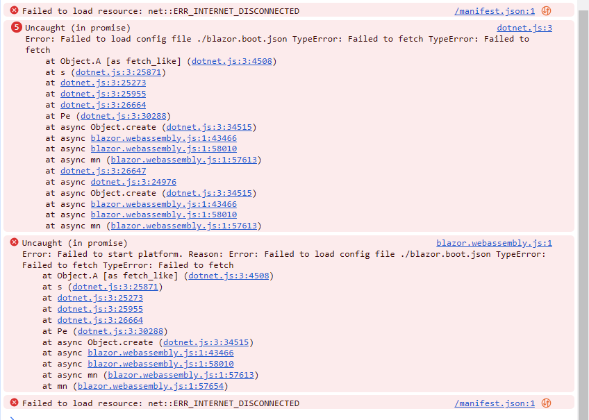

I have a Blazor WASM app in VS 2022 Community v 17.10.1 that I am trying to run offline, but am getting several "failed to load resource" and one "failed to register a Service Worker" exceptions as shown below.

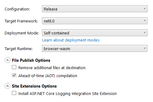

I'm publishing to Azure with the settings shown below. When I run the published app, the icon that let's me install it appears as it should in the address bar and when I run the installed app it works. But when I disable internet access, the installed app throws the exceptions shown below, including a failure to load manifest.json and blazor.boot.json.

Publish Settings

    check that you deployed the service-worker-published.js version. the dev version does no caching.
