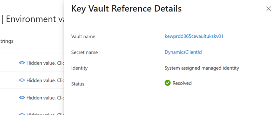

The issue is that in function apps we are using Environment variables which sourced from a key vault using a user assigned managed identity. System assigned managed identities have been turned off, however the environment variables still show that the system assigned managed identity is being used to access the key vault.
The Function Apps:
·       Are using User Managed Identities
·       Are NOT using System Assigned Identities.
·       Are configured to use the User Managed Identity for Key Vault Secret lookup
o   ie: "keyVaultReferenceIdentity": "/subscriptions/6705ce6c-074a-417f-bbe0-9a92f3452d51/resourceGroups/RBGKew-PROD-D365CE-Application-UKS-RG/providers/Microsoft.ManagedIdentity/userAssignedIdentities/RBGKew-PROD-D365CE-FunctionApps-UKS-ID-001",
They are successfully retrieving the secrets, but the portal still indicates it is using SystemAssigned Identity when it is now.

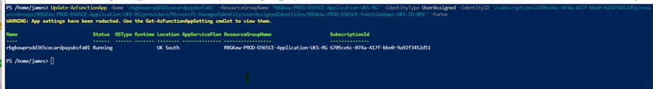

As a work around we tried to manually update the key vault Identity with below command using PowerShell. The command ran successfully but UI didn't change yet.
Update-AzFunctionApp -Name 'rbgkewprodd365cecardpayuksfa01' -ResourceGroupName 'RBGKew-PROD-D365CE-Application-UKS-RG' -IdentityType UserAssigned -IdentityID '/subscriptions/6705ce6c-074a-417f-bbe0-9a92f3452d51/resourceGroups/RBGKew-PROD-D365CE-Application-UKS-RG/providers/Microsoft.ManagedIdentity/userAssignedIdentities/RBGKew-PROD-D365CE-FunctionApps-UKS-ID-001' -Force

    What you are seeing is normal (even though it is incorrect). In my experience the portal shows "System assigned managed identity" regardless of whether you are using System or User-assigned managed identity.
    When using user-assigned managed identity the important difference is you need to set keyVaultReferenceIdentity, which you have already done.
    If you are still concerned that somehow it is using system-assigned managed identity even though you've turned it off, you can turn on audit logging on your key vault and verify in logs that user-assigned identity is being used.
