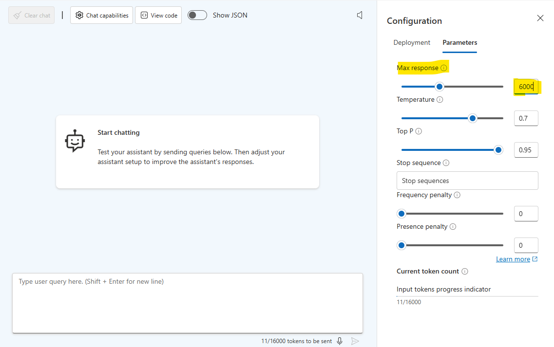

Hello Manoj Prasad, firstly ensure that you execute the same operation in Azure AI search and you're getting the 80 rows for the query. If you don't get 80 rows directly, then, that clearly shows a mismatch in expectations as you're expecting 80 rows while the AI Search is giving a different number of rows. So, you need to iron out this difference. However, if the AI Search gives you 80 rows as expected and you're getting 20 rows via Azure portal and 5 rows via the API, then, this is likely due to one of the configurable parameters. Most likely, in the Chat Playground, increasing the "Maximum length" parameter (or in the case of API, increasing the "max_tokens") will lead to an increase in the number of rows returned by the service.
