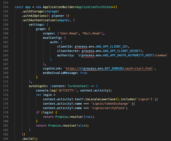

Maybe not the code but an azure resource configuration is the problem, but anyway my app example code is here:

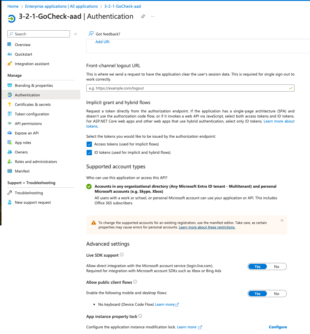

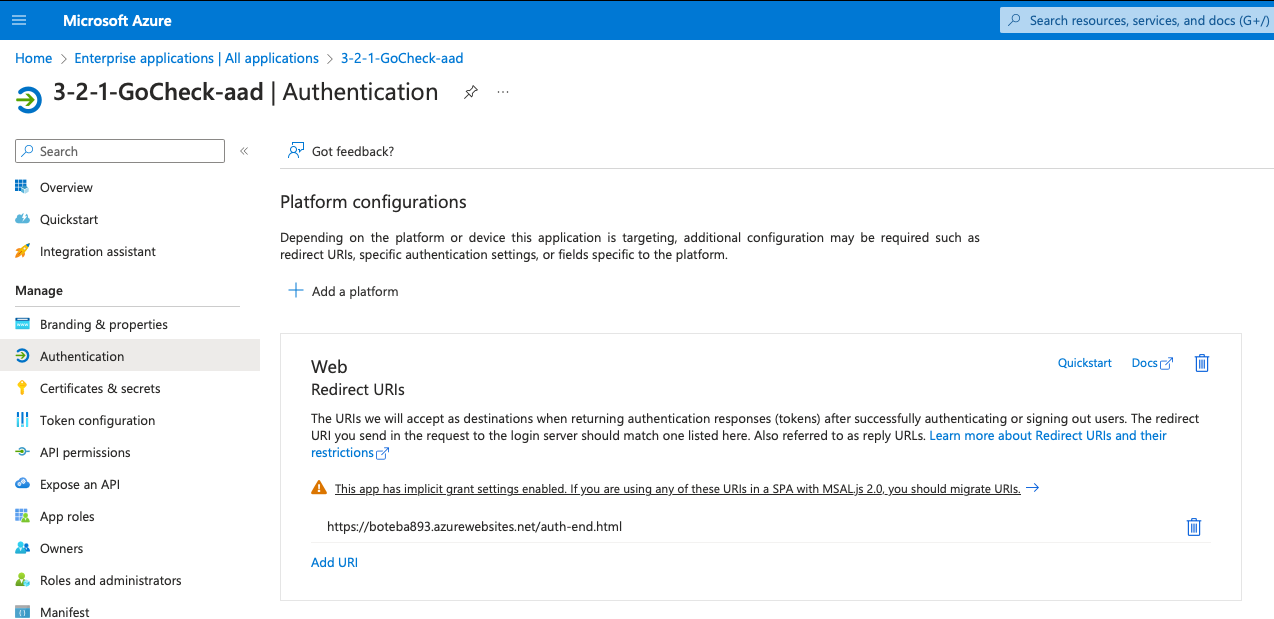

2024-06-18T10:55:18.01+00:00 And this is the configuration of my azure resource.

2024-06-19T10:52:43.6133333+00:00 In 1.1.65 I changed the sign in code in this way.

2024-06-19T10:59:29.5833333+00:00 app.message(/^signin\s*$/i, async (context: TurnContext, state: ApplicationTurnState) => { let token = await app.getTokenOrStartSignIn(context, state, 'graph'); if (token) { await context.sendActivity(`[Already signed in]`); } });

2024-06-25T12:11:26.9833333+00:00 @Nivedipa-MSFT , yes, this is the sample I initially took. But seems this only works for internal org users. So I made some changes to make it available for public.
aad.manifest.json:
"signInAudience": "AzureADandPersonalMicrosoftAccount",
"oauth2AllowIdTokenImplicitFlow": true,
"oauth2AllowImplicitFlow": true,

index.ts:
graph
msalConfig
auth authority: `${process.env.AAD_APP_OAUTH_AUTHORITY_HOST}/common`
endOnInvalidMessage: false
auth-start.html:
let authorizeEndpoint =
https://login.microsoftonline.com/common/oauth2/v2.0/authorize?${toQueryString(queryParams)}

2024-06-25T13:50:30.58+00:00 "signInAudience": "AzureADandPersonalMicrosoftAccount", "publisherDomain": "321gocheck.com", "oauth2AllowIdTokenImplicitFlow": true, "oauth2AllowImplicitFlow": true, authority: `${process.env.AAD_APP_OAUTH_AUTHORITY_HOST}/common` let authorizeEndpoint = `https://login.microsoftonline.com/common/oauth2/v2.0/authorize?${toQueryString(queryParams)}`;

- Update the line: "signInAudience": "AzureADMyOrg" => AzureADMultipleOrgs
Ref Doc: teams-ai/js/samples/05.authentication/d.teamsSSO-bot/aad.manifest.json at main · microsoft/teams-ai (github.com) - Follow the guide and change the account type = AzureADMultipleOrgs
Ref Doc: How to: Change the account types supported by an application

2024-06-27T12:31:23.12+00:00 @Nivedipa-MSFT , the version I released to the testing team was with AzureADandPersonalMicrosoftAccount, so It should work for out of org users. And already made those changes according to point 2.
Mate Varga • 0 Reputation points
2024-06-27T12:33:40.1+00:00 @Nivedipa-MSFT , the way I deployed is already with AzureADandPersonalMicrosoftAccount, and /common url for authority. Not sure why it was not working for the Microsoft testing team with out of org user.

2024-06-28T04:45:59.47+00:00 Mate Varga - what do you mean by 'out of org user'? Are you referring to guest users or you are referring to a user from a different tenant?
For your app to work with different tenants you just need to set the app type as AzureADMultipleOrgs.
2024-06-28T05:48:19.8933333+00:00 I mean all users who has ms365 and out of our organization.. So including personal accounts with ms365. So the changes I made related to the common url is not required right? And oauth2Allow* properties also not required to be set to true right?
