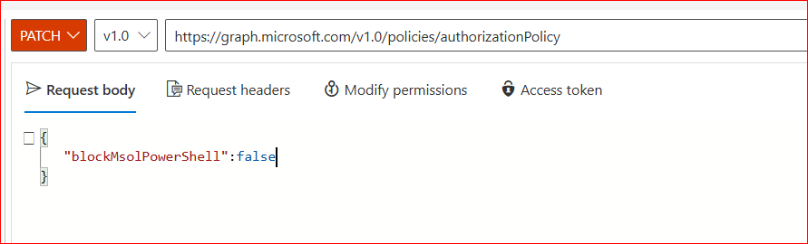

    As I understand that you are facing an issue while installing Azure AD connect. You are getting an error message "Unable to retrieve the Azure Active Directory configuration. Exception of type ‘Microsoft.Online.Administration.Automation.MicrosoftOnlineException’ was thrown."
    Using graph explorer, can you check the authorization policy in Azure AD by using Get authorization policy method and check if "blockMsolPowerShell" equals True. When blockMsolPowerShell policy setting is True, any MSOL command will be denied access.
    For your reference: Get authorizationPolicy
    GET https://graph.microsoft.com/v1.0/policies/authorizationPolicy
    To resolve this issue, you will have to allow MSOL PowerShell by setting blockMsolPowerShell setting to False, using the following Update authorizationPolicy request:
    For your reference: Update authorizationPolicy
    Hope this helps. Do let us know if you any further queries. If the issue still persists, feel free to post back.
