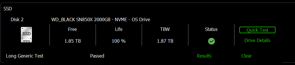

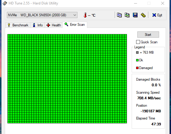

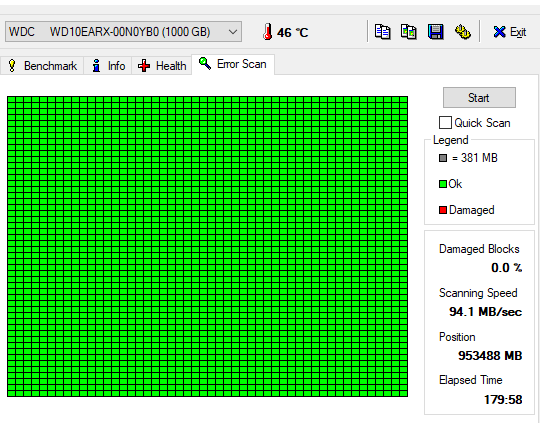

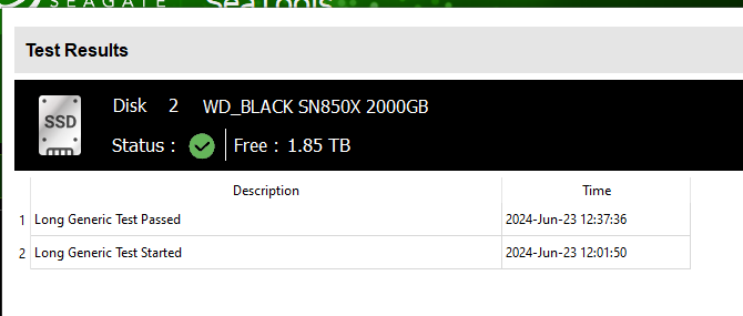

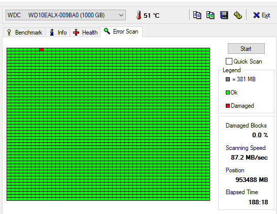

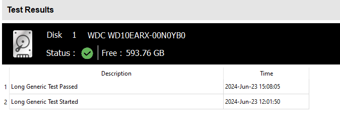

    a) Drive bad block
    b) Windows failed fast start up
    1)Run HD Tune Full error scan (all drives) > post images or a share link
    2)Run Sea Tools for Windows Long generic test (all drives) > post images or a share link
    3)Turn off Windows fast startup
