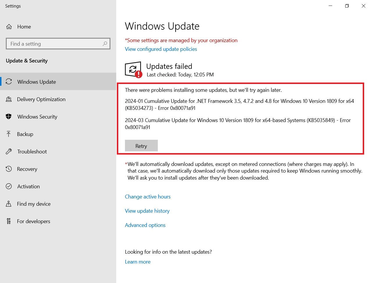

I have an WSUS Offline Server, from that i am pushing the windows 10 updates to all my computers , I am getting the error code 0x80071a91 only for one system , Remaining all Windows 10 systems patch update is successful. Only one system failed resulting the error code.
Can anyone help to solve the issue.

    Hello,
    The error code 0x80071a91 is typically associated with issues related to the Windows Update database.
    Try the steps below to check:
    Fix 0x80071a91 Windows Update Error Code (thewindowsclub.com)
    Best Regards,
    Hania Lian
  2. Adam J. Marshall 10,456 Reputation points MVP
    2024-06-23T08:54:57.8166667+00:00
    Run the client side script on the affected client after removing the computer from the WSUS MMC Console.
    https://www.ajtek.ca/wsus/client-machines-not-reporting-to-wsus-properly/
