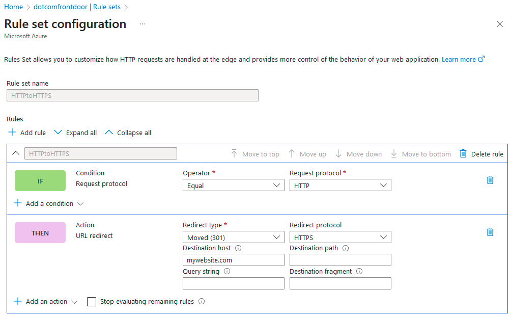

I have encountered a 307 Temporary Redirect alert on my website, which is being caused by a redirect between http:// and https://.
This then appears to be contributing to another alert, which states that the 'home page appears to have no server-side 301 redirect from WWW to non-WWW website version or vice versa'. However I have set up a Rule in the app service with a 301 to redirect http content to https, and so I am uncertain as to whether there is an issue with this.
I am not very familiar with Azure architecture, unfortunately, and do not know exactly where to look for a configuration setting to fix this issue - I have audited the app portal interface as best I can but this has not revealed any answers up to now.
Is there a setting I can use within the app portal to address this problem?
Additionally, there is a web.config file in the root FTP directory of the app that i can access if this needs to be modified as I understand may be the case.
Many thanks in advance for any assistance.
