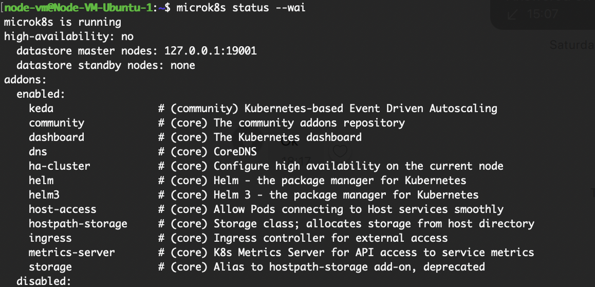

I am failing to install AppService extension into my Arc K8s cluster, running by MicroK8s.
Have a VM in datacenter, Ubuntu 22, installed lates Azure CLI and all the required extensions according to https://azurearcjumpstart.com/azure_arc_jumpstart/azure_arc_k8s/microk8s/local_microk8s article.
Installed MicroK8s with the following extensions
Tried to use "default" and "microk8s-hostpath" storage classes.
Tried to add extension from UI and from this command:

```It takes ages, more than 20 minutes, then fails - shows "Provisioning state - Failed".
Cannot get any logs off it - not sure what fails and because of what reason. Please advise?
Perhaps, this combination: Ubuntu 22 x64 + MicroK8s + Arc AppService Extension - does not work?
Many thanks!
