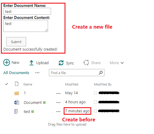

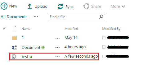

    I have tested the Rest API https://{site_url}/_api/web/GetFolderByServerRelativeUrl('Folder Name')/Files/add(url='a.txt',overwrite=true). When you set parament overwrite=true, the newly created file will override the file with same name already exists.
    File created before:

    File created new:
