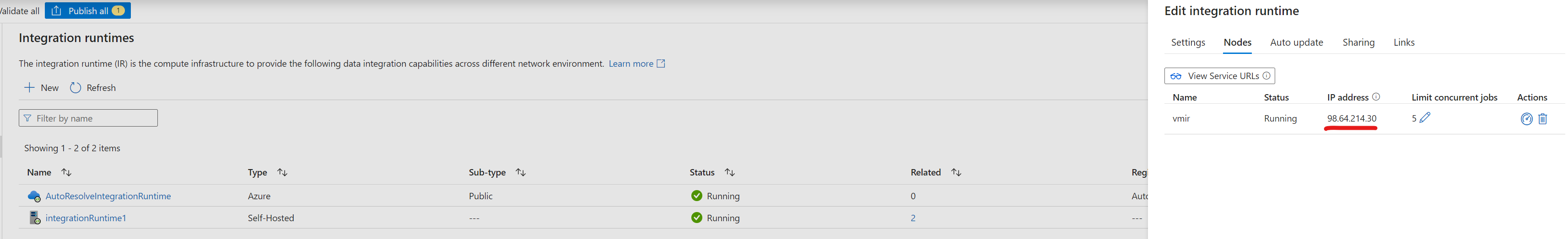

  4. Azure Windows Server 2019 VM with Self-Hosted Integration Runtime installed and Public IP from 3
  5. Storage Account with the Enabled from selected virtual networks option and IP addresses selected and my Local IP address AND IP from 3

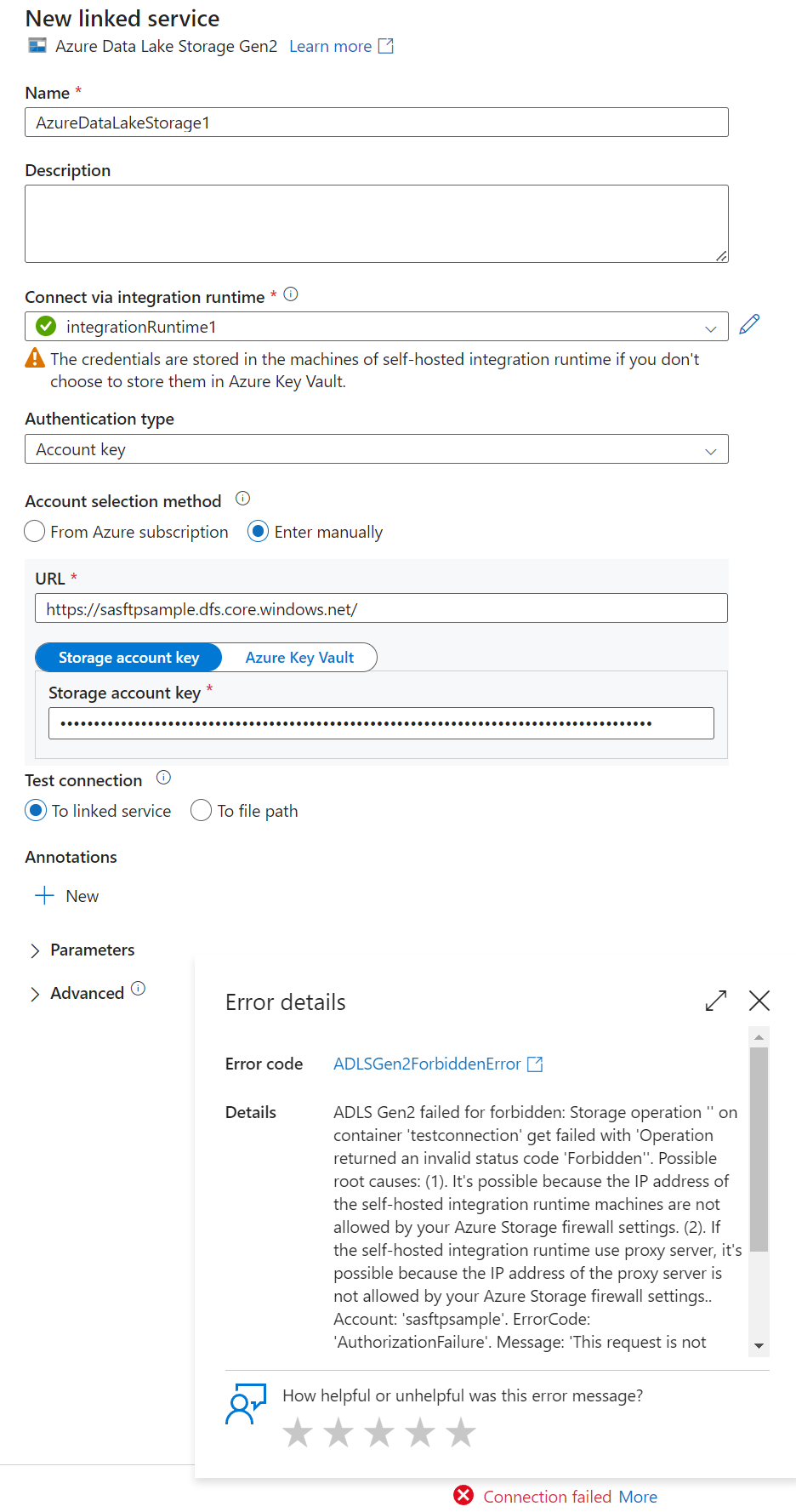

Unfortunately I am not able to add the SA as a linked service, somehow the SA Whitelist cannot accept the SHIR IP:
I have no idea what am I doing wrong here and would really appreciate some help.

    This request is not authorized to perform this operation - the error message is due to authentication failure when trying to access a resource. Please check the service principal or identity you’re using has the necessary permissions. Specifically, make sure it has the ‘Storage Blob Data Contributor’ role assigned. You can do this in the Azure Portal by going to your Storage Account, selecting “Access Control (IAM),” refer similar thread for reference - https://stackoverflow.com/questions/73388655/status-403-this-request-is-not-authorized-to-perform-this-operation-using-this.
    The issue may be your ADF is not in the same Vnet as the storage account. If you enable "enabled from selected virtual networks and IP addresses" and configured firewall (not using Vnet) then you can enable "Allow Azure services on the trusted services list to access this storage account." to access the storage account via ADF. Please see the below blog for more details.
    https://techcommunity.microsoft.com/t5/azure-data-factory-blog/data-factory-is-now-a-trusted-service-in-azure-storage-and-azure/ba-p/964993
    Also please make sure your client's public IP address is allowed. In other words, you need to have the public IP address of the client PC you are using to access the Azure Portal. If you don't you will receive an error.
    "Allow Azure services on the trusted services list to access this storage account." works only when you configured the firewall refer - https://techcommunity.microsoft.com/t5/azure-paas-blog/troubleshooting-storage-firewall-issues/ba-p/1944730

    Based on the screenshots you provided, it looks like the IP address of your Self-Hosted Integration Runtime is not being accepted by the Storage Account firewall. Here are some steps you can follow to troubleshoot this issue:
    1. Check if the IP address of your Self-Hosted Integration Runtime is correct. You can find the IP address of your Self-Hosted Integration Runtime by going to the VM where it is installed and running the command ipconfig in the command prompt.
    2. Check if the IP address of your Self-Hosted Integration Runtime is added to the allowed IP addresses in the Storage Account firewall. You can do this by going to the Storage Account in the Azure portal, selecting "Firewalls and virtual networks" from the left-hand menu, and then adding the IP address of your Self-Hosted Integration Runtime to the list of allowed IP addresses.
