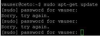

Hello,
I have deployed a Virtual Machine with a STIG Ubuntu 18.04 image. I have successfully accessed the machine via SSH and started issuing commands; however, I am unable to run apt-get update, apt-get upgrade, etc. I have tried these commands with sudo, but it claims the password is incorrect although I have set it using passwd. How can I run apt-get update and related commands?
