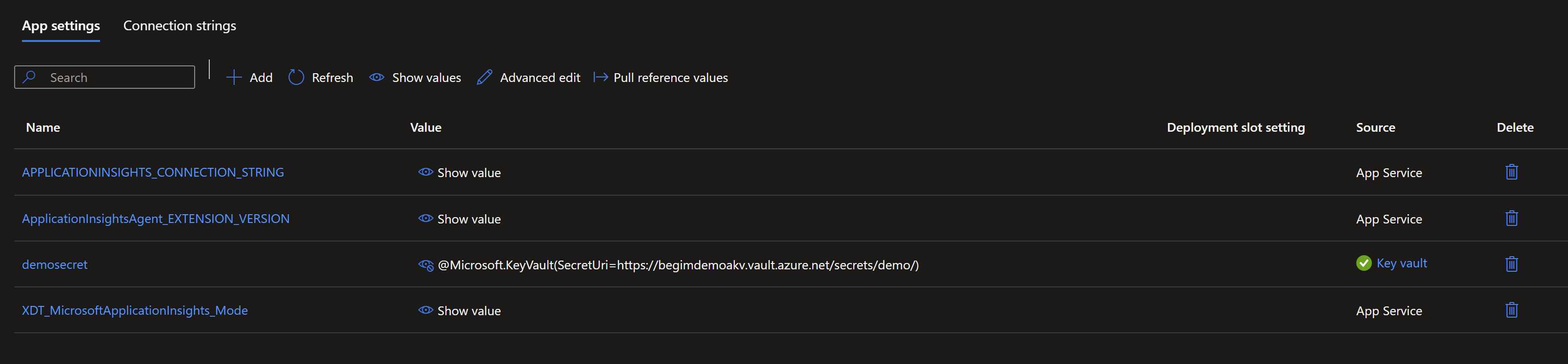

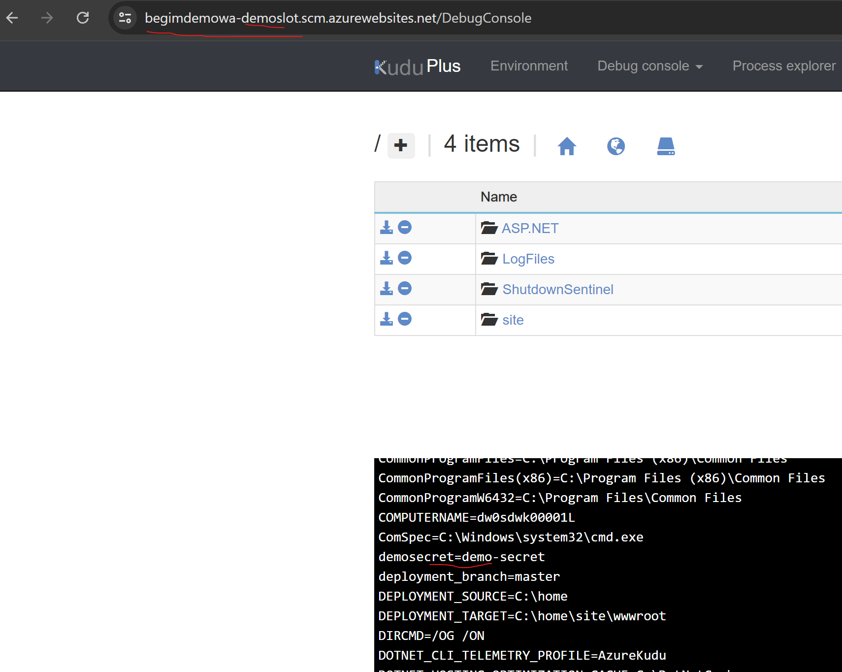

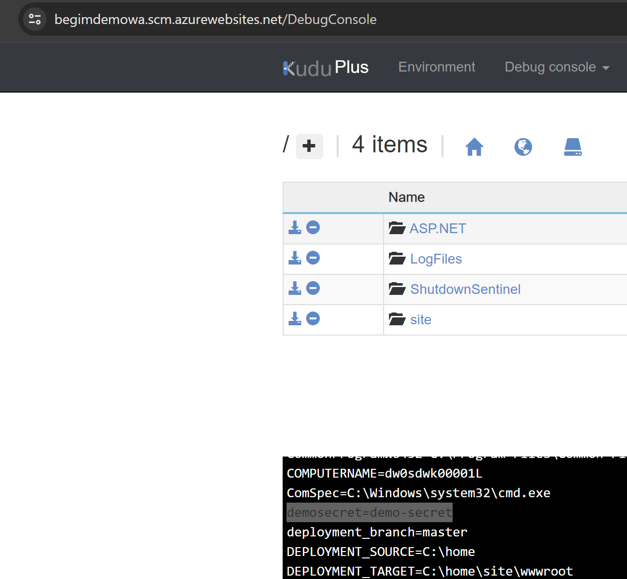

    This works for me so long as I ensure both the app and the slot
    (a) Is linked to a user msi
    (b) make sure the user msi is assigned to the slot and that keyvault reference knows to use it as per https://learn.microsoft.com/en-us/azure/app-service/app-service-key-vault-references?tabs=azure-cli#access-vaults-with-a-user-assigned-identity
    The user MSI is the same for the site and the slot
    Slot
    Site
    KV REF (identical for site and slot)
