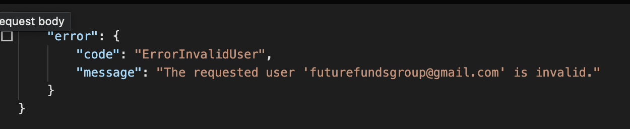

Instead, I am trying to use the "/users/{user-id}/" path to fetch and read emails from from my outlook email's inbox, which I read does not require a manual user sign-in. For example, here is the endpoint that I would like to have work (I am trying to fetch the messages inside of the email for ******@futurefundsgroup.com): https://graph.microsoft.com/v1.0/users/******@gmail.com/messages
However, when I do this, I get the following error on the Graph API tool (linked above):

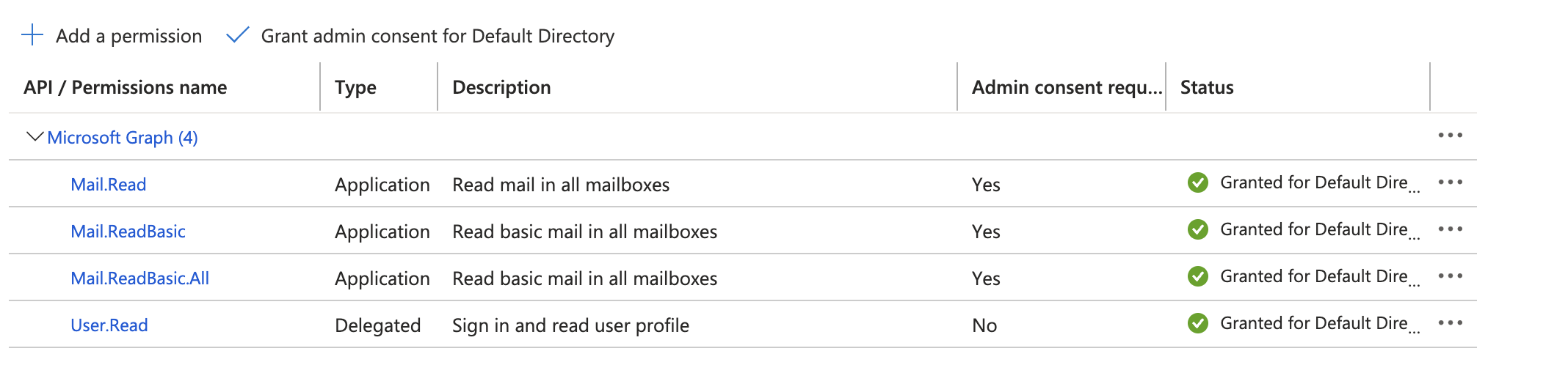

Note that I have registered my application and have set the following API permissions: User's image

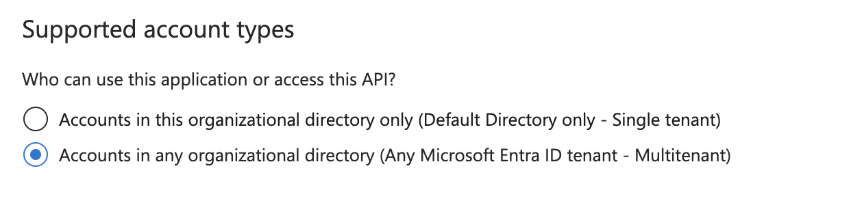

These are my authentication settings (not really sure at all what this does or if this makes a different in my case):

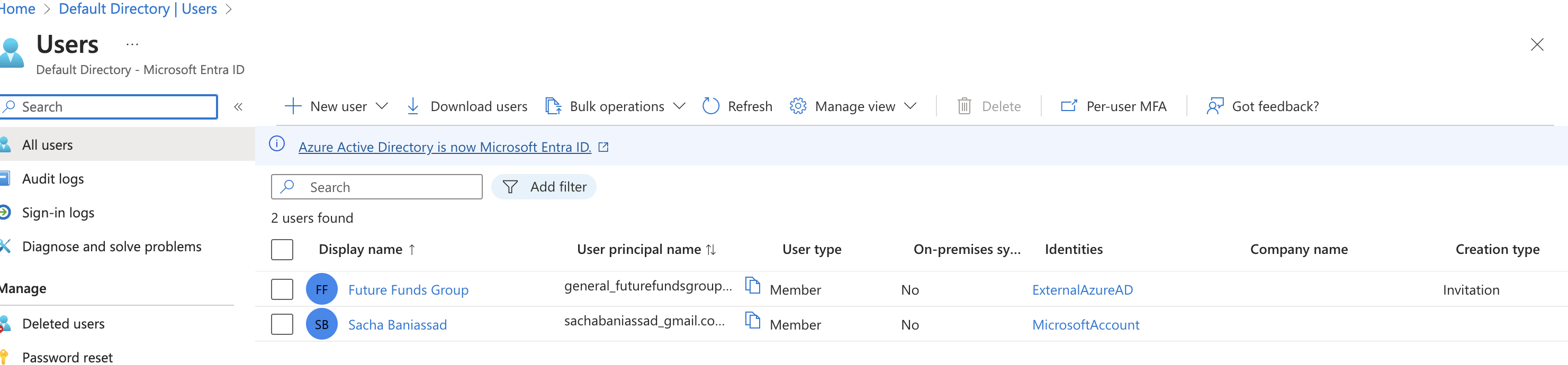

And this is my Azure active directory. For it, I have created a new Azure account for the email "******@futurefundsgroup.com", and I invited it to the application in hopes that this would resolve my issue. But unfortunately, it did not:
I'm really out of ideas here. What could I do to have this work? Please note that I created the Azure application on a separate email, and then added ******@gmail.com to the Azure AD manually.

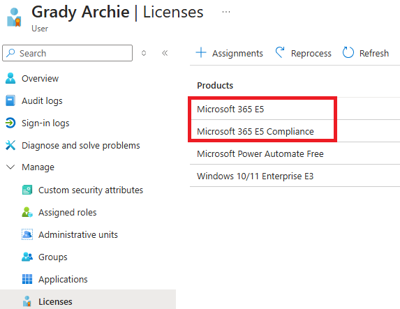

    After you create a ******@gmail.com user in Azure, you need to grant the user MS 365 Licenses as well, as shown below:
    Screenshot 2024-06-26 152819

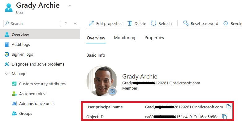

    And when accessing the user, it needs to pass the principal name or Object ID of the user, as shown in the figure below:
    Screenshot 2024-06-26 153125
