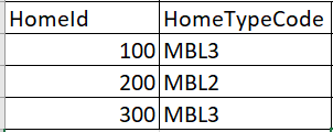

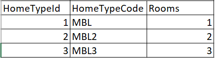

    TBLHomeType - This is master table which will have information about different home types like mobile home, travel trailers etc.
    TBLHomes - This is master table which will have relation with home type with mobile home numbers.

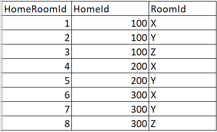

    TBLHomeRoom - This table contains the data about which home has how many rooms and what is the name of those rooms.

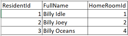

    TBLResidentsHome - This table contains the data about which resident lives in which home and which room.
    Now if we need to find which resident lives where we can use below query directly:
    SELECT TRH.ResidentId,TRH.FullName,THR.HomeId,THR.RoomId FROM TBLHomeRoom THR
    INNER JOIN TBLResidentsHome TRH ON THR.HomeRoomId = TRH.HomeRoomId
    If we would like to know empty rooms, we can fire below query:
    SELECT THR.HomeId,THR.RoomId FROM TBLHomeRoom THR
    LEFT OUTER JOIN TBLResidentsHome TRH ON THR.HomeRoomId = TRH.HomeRoomId
    WHERE TRH.ResidentId is NULL
