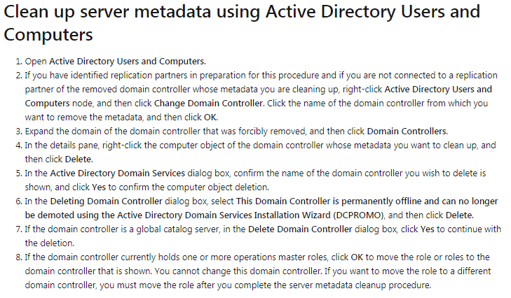

    • The method which you mentioned, I have used exactly that when I removed the DC1 and DC2:
    https://learn.microsoft.com/en-us/windows-server/identity/ad-ds/deploy/ad-ds-metadata-cleanup

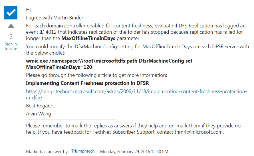

    • For this event log error in Server Manager of DCFS3:
    The DFS Replication service stopped replication on the folder with the following local path: C:\Windows\SYSVOL\domain. This server has been disconnected from other partners for 2421 days, which is longer than the time allowed by the MaxOfflineTimeInDays parameter (60). DFS Replication considers the data in this folder to be stale, and this server will not replicate the folder until this error is corrected.
    To resume replication of this folder, use the DFS Management snap-in to remove this server from the replication group, and then add it back to the group. This causes the server to perform an initial synchronization task, which replaces the stale data with fresh data from other members of the replication group.
    Additional Information:
    Error: 9061 (The replicated folder has been offline for too long.)
    Replicated Folder Name: SYSVOL Share
    Replicated Folder ID: 07A577BE-C0A6-4A93-BEA4-A071CB272007
    Replication Group Name: Domain System Volume
    Replication Group ID: E5365EDF-05D4-4E8C-9B80-4170893FB51
    Can I use this the below method and maybe all errors will be corrected?
    https://social.technet.microsoft.com/Forums/ie/en-US/c57791e6-c4f4-4e8f-9a74-eab985ecf614/event-id-4012-the-dfs-replication-service-stopped-replication?forum=winserverDS
