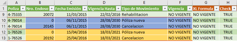

    Hi @Shinka
    EDIT: Code posted on Sat. 28th had a mistake, revised below. Apologies
    Sorting on [Vigencia Hasta] was an idea but this won't work for certain cases, look at the one in blue:
    I had to rework the logic partly due to your yearly [Poliza] with monthly [Nro. Endoso]s but not only...
    In this demo I combined data from your 1st and 2nd samples (just to get more scenarios) and applied the new logic that produces the same results as your formula(1)
    Note that I had to bring your list of cancelations ("Cancelacion","Cancelación Corto Plazo","Cancelación Plurianual") into the picture. Check the results in the demo and if that's OK replace (in the previous version of the query I posted) the Steps after #"Columnas combinadas" with:
        Cancelations = List.Buffer({"Cancelacion","Cancelación Corto Plazo","Cancelación Plurianual"}),
        GroupedByPoliza = Table.Group(#"Columnas combinadas", {"Poliza"},
            {"NestedPolizaRecords", each
                let
                    MaxDate = List.Max([Vigencia Hasta]),
                    TipoMovimientoMaxDate = Table.SelectRows(_, each [Vigencia Hasta] = MaxDate),
                    Vigente =
                        if Table.Last(TipoMovimientoMaxDate)[Vigencia Hasta] < Date.From(DateTime.LocalNow())
                            then false            // NO VIGENTE
                        else if List.ContainsAny(TipoMovimientoMaxDate[Tipo de Movimiento], Cancelations)
                        else true,                // VIGENTE
                    EndosoZeroAtTop = Table.Combine({
                        Table.AddColumn(Table.SelectRows(_, each [Nro. Endoso] = 0),
                            "Vigencia", each "VIGENTE", type text
                        Table.AddColumn(Table.SelectRows(_, each [Nro. Endoso] <> 0),
                            "Vigencia", each "NO VIGENTE", type text
                in
                    if Vigente then EndosoZeroAtTop
                    else Table.AddColumn(_, "Vigencia", each "NO VIGENTE", type text),
                type table
        CombinedNestedTables = Table.Combine(GroupedByPoliza[NestedPolizaRecords])
    in

  2. Lz._ 9,016 Reputation points
    2020-12-01T08:02:34.803+00:00
    @Shinka
    Hopefully you should be good with:
                let
                    Vigente =
                            then "NO VIGENTE"
                            then "NO VIGENTE"
                        else "VIGENTE"
                in
                    Table.AddColumn(_, "Vigencia", each Vigente, type text),
                type table
    in
