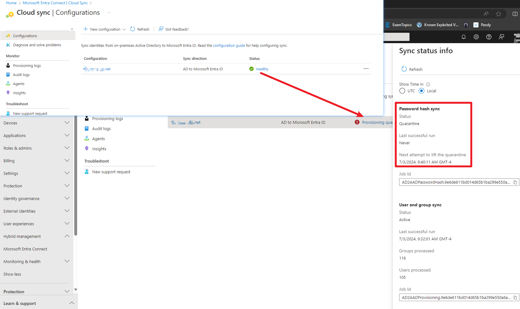

After reinstalling the Azure AD Connect Sync and provisioning agent on an existing environment, the error:
Password hash sync
Status: NotRun
Last successful run: Never
Job Id :AD2AADPasswordHash.9e6de611bd014d65b1ba299e550a6ae8.c4599863-b31a-4327-bcfb-12430ddd6065
Keeps showing non stop. all services are Up and running on the on premise DC, Agent is healthy, FW rules are as set in documentation but releasing the Password hash sync error from "provisioning quarantine" into Healthy state only last 1 minute.
A ticket with Microsoft is already in place but after 3 days no answers. thoughts?
DC is a Win 2022 Server (Azure VM)
Azure AD Sync Agent is 2.3.8

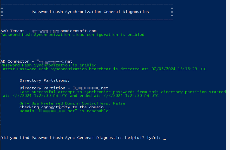

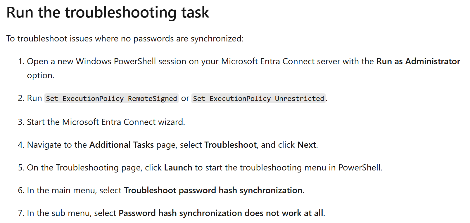

    Are you experiencing any issues to sync users or only with the passwords? Do you know if the Password Sync is failing for all the users?
    Please, run the AD Connect Troubleshooter (if you haven't yet) and select the password sync option and share the results in here
    https://learn.microsoft.com/en-us/entra/identity/hybrid/connect/tshoot-connect-password-hash-synchronization#run-the-troubleshooting-task

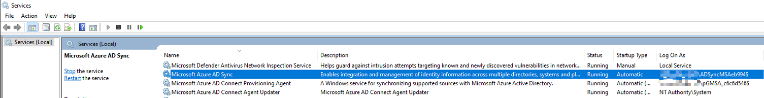

    Check the status of the Azure AD Connect synchronization service:
    On the local server, open Services and see if the Azure AD Connect synchronization service (usually Microsoft Azure AD Sync) is running.

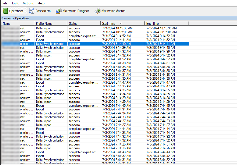

    View the synchronization logs:
    Open Azure AD Connect, go to the Troubleshooting tab, and use the Synchronization Service Manager to view detailed error logs. This may provide clues as to why the PHS is not running.
