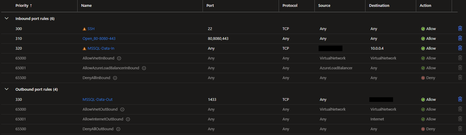

The Network Settings panel has rules that allow both inbound and outbound connections to the external MS SQL Server on port 1433, and running a tcpdump command to capture the traffic during a query shows that no packages have been dropped. But the Metrics Panel shows that only 91 KiB have been transferred in over the network, while the data in the result set is 1.7 MiB not including the data in the TCP frames.
