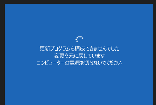

■Error in when installing KB5005625 (0x8000f0922)
After running the KB5005625 installer, a reboot is required.
After that, the update to about 80% before the image below is displayed and fails
(Translation for below image: Cannot complete the update, back to before update condition)
スクリーンショット (1880)

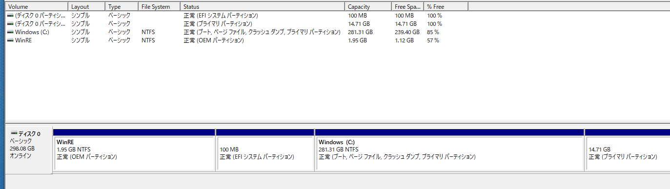

Is it because of my disk space?
disk (1) (1)

    Error 0x8000f0922: This error can occur due to various reasons such as problems with the .NET Framework, issues with the system files, or even network connection issues.
    You can try the following methods to resolve this issue:
    Run the Windows Update Troubleshooter.
    Use the Command Prompt to stop and start certain services, and rename the SoftwareDistribution and Catroot2 folders.
    Use the System File Checker to repair possible corrupted or missing system files.
    If all else fails, you can try to download and install the update manually.
    Windows 11 update error 0x800f0922 - Microsoft Community
    Disk Space: Insufficient disk space could indeed cause issues with installing updates. Make sure you have enough free space on your system drive. As a rule of thumb, keep at least 10% of your total disk space free for system operations.
