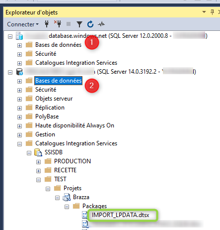

Hello I would like to execute SSIS package ona SQL azure server but SSISDB is on a different server
I would like to execute my SSIS on database (1) but my SSIS is on server (2)

    Hello thank you for your answer but I think its not my subject.
    I know how to connect a database on a server.
    My question is, how I can run a SSIS in stored procedure on my server (1) if my SSISDB is on my server (2) ?

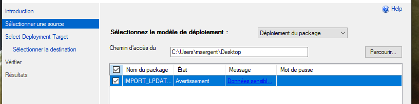

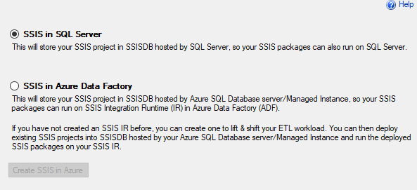

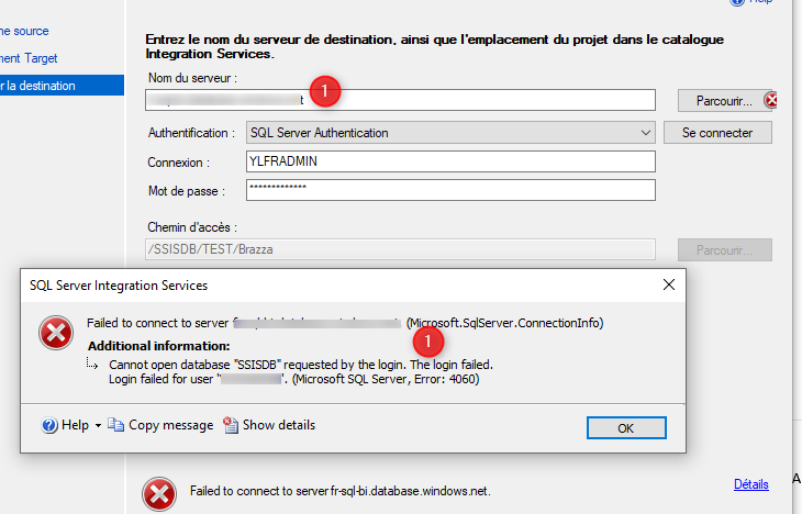

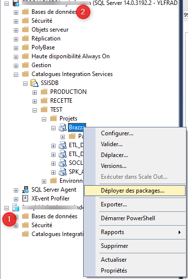

    I tried to deploy my package from server (2) to server (1)
    I choose my package
    but SSMS told me that i don't have SSISDB on my server (1), if I had I will deploy directly on my server (1), so I can't do this
