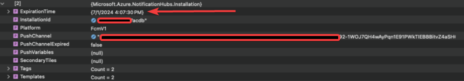

we're working on an application that uses Azure Notification Hub for sending push notifications. The application utilizes Notification Hub .NET SDK v4.2.0 to communicate with the Notification Hub. To register a device for push notifications, the app creates an installation with an expiration time specified and persists it in the Notification Hub using the _hubClient.CreateOrUpdateInstallationAsync(installation, token) method of the SDK. However, per our observation, such installations are not removed after they pass the expiration date. For example, in the screenshot below you can see that there is an installation present in the Notification Hub that has an expiration date set to 07/01/2024, so it has not been removed considering that two days have passed since the expiration time.
Is it a bug in the Notification Hub or are we missing something?

    To manage expired installations, you might need to implement a cleanup process in your application. This process could periodically check for and remove installations that have passed their expiration date. You can use the GetAllRegistrationsAsync method to retrieve all installations and then filter out the expired ones for deletion.
