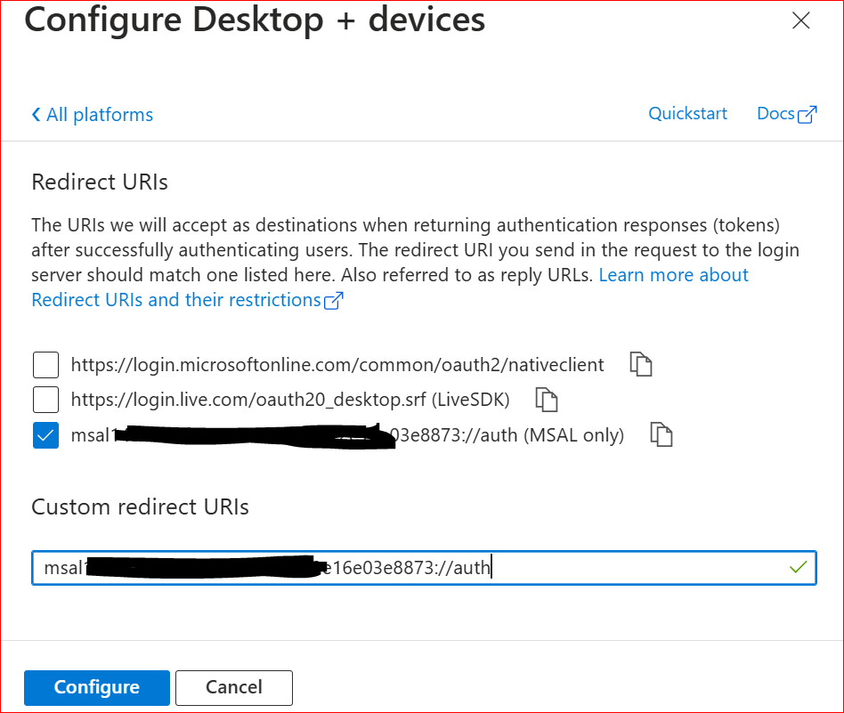

    I can't add the redirect uri because it is msal<clientId>://auth, and it expects the uri to start with https:// *
    Redirect URIs support msal<clientId>://auth in native application registration.*
    To add a redirect URI to your MAUI application, you can follow the below steps
    1.Open your MAUI application, select the Authentication blade to the left.
    2.Select Add a platform and select the public client/native (mobile & desktop) option.
    You should be able to find the msal{YOUR_CLIENT_ID}://auth option under Redirect URIs. Please select it and click on 'Configure'. If the msal{YOUR_CLIENT_ID}://auth option is not visible, you may need to add it as a custom redirect URI.

    I had to add the iOS option to the endpoints and then use that in my MAUI app. Also, the code that i got down from GitHub overrode one of the methods in the MainActivity of the iOS platform and that seemed to cause the problem. Once I removed the override and moved the initialisaition of PublicSingletonClient to the constructor of the MainActivity, I got the app to work. There were a few more tweaks needed, but I got the app to work in both Android and iOS. All I need to do now is create a new provisioning profile on Apple with Keychain access enabled so that I can create an IPA file
