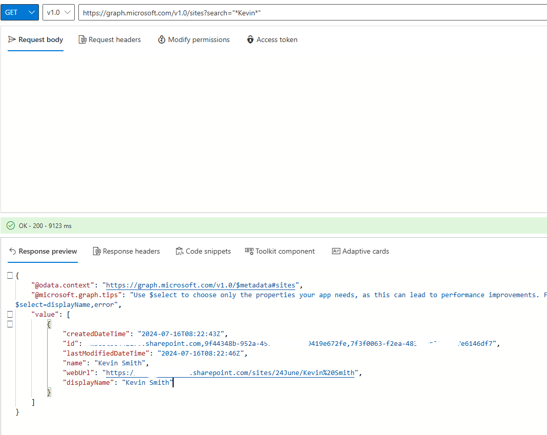

    Thank you for your reply.According to your problem description, I conducted a test and found that our search = Kevin will only return results for sites starting with Kevin string.
    For example, if one of our sites is xxxKevin or xxxKevinxxx, they will not be in the search=K query results.
    Therefore, I suggest you use fuzzy search, such as search=Kevin* or search=*Kevin* . Then check whether the returned results are correct. Hope this helps you.
  2. Ling Zhou_MSFT 23,620 Reputation points Microsoft External Staff
    2024-07-16T08:31:56.89+00:00
    Hi @Vlad Vantaroo,
    Apologies for the late reply!
    I did a lot of testing and tried to find out why the site wasn't searched, but I'm sorry that the search results here are all working fine.
