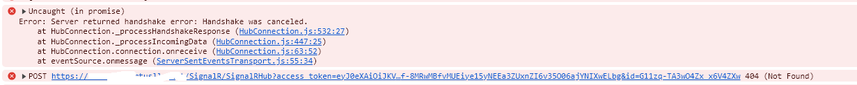

While connecting SignalR in the development environment (locally) using SSE, the reports run fine. But once SignalR API is deployed in the Azure Service Fabric cluster, it throws an error while consuming from the frontend application - "Error: Server returned handshake error: Handshake was canceled," and ultimately SignalR connection id is not generated.
SF_Error_1

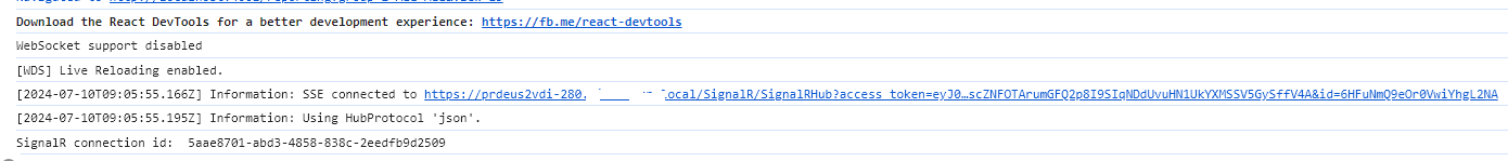

Locally, SSE successfully connects -
SF_SSE_Success
