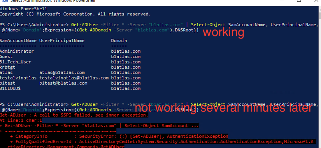

I try to setup a domain forest on my Windows machines, and actually I can do it successfully and can list the domain users from other trusted domain, but several minutes later it does not work any more:
User's image Then I check the properties of this domain trust, it says "can not find an Active Directory Domain Controller":
Why this error happen? Thanks.

    Hello Gong, Allen,
    Thank you for posting in Q&A forum.
    The error message usually indicates a connectivity or configuration issue between the Active Directory (AD) domains involved in the forest trust.
    Here are a few steps you can take to troubleshoot this issue:

    9.Check has someone made any changes in this domain and the other domain during the several minutes.
