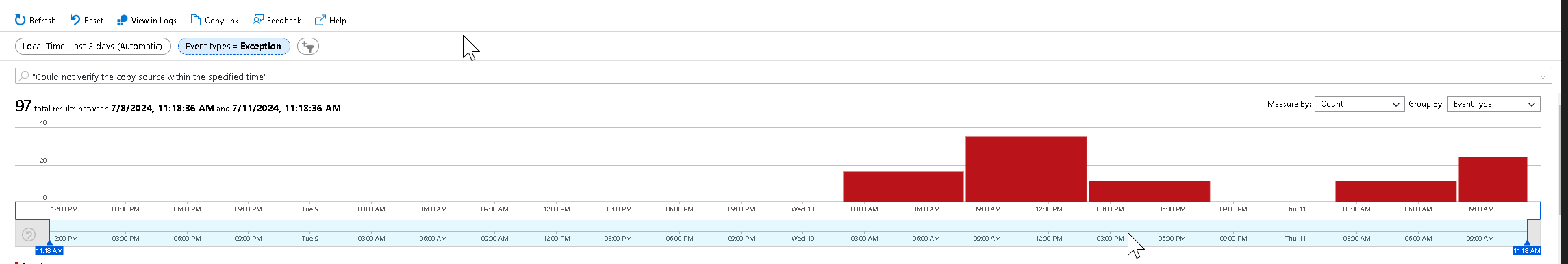

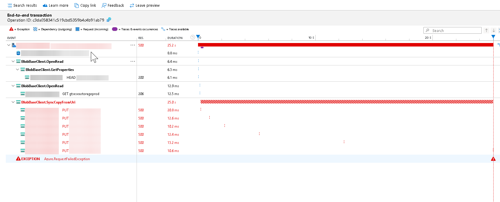

Hi Everyone,
Getting 500(Could not verify the copy source within the specified time) error for some operations using SyncCopyFromUri. It started happening since yesterday morning. It is happening every around 40min for some of the requests and then its ok for next 40min.  It is not an issue with SAS URL since we generate it the same way and for most of the requests it goes ok. The failed one is going also ok after user retry its operation one or few more times. We thought that is its temporary storage issue and it will not last long, but unfortunately it is still there. We checked Yesterday code on our end, and everything looks ok. (our other environments works perfectly fine with the same versions)
We didn’t change anything connected to blob storage in our app last days and it appeared from nowhere.  We can see that in most of the cases when there is this exception it is retried by Microsoft SDK DLL (it makes 6 retrials) but when it does not manage to copy file successfully than we get an exception and the user must repeat his actions in the system.
Do You have any idea what may be the issue that it is happening?Photos_rMVLmlXwBB

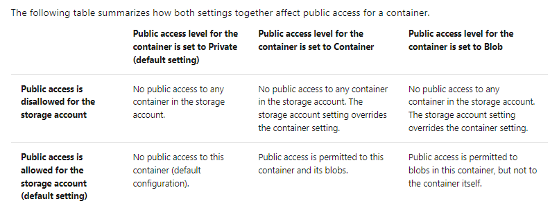

    I understand that you are encountering a issue with the SyncCopyFromUri operation, it typically occurs when there is a timeout or connectivity issue while trying to access the source file. Please consider checking the below following factors to troubleshoot the issue,
    • Can you please check the access level, that would be causing the issue Lear more here on access level
    • Make sure that the account name/key is proper
    • Blob service error codes
    • By default, container data is private to the account owner. Use 'Blob' to allow public read access for blobs. Use 'Container' to allow public read and list access to the entire container. It's at the container level
