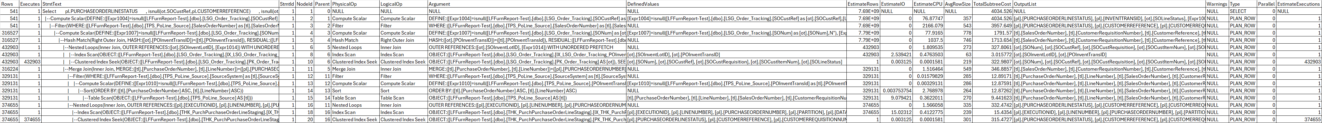

    First compare the execution plan of both queries to see if, there are differences, may one don't use the right index etc.

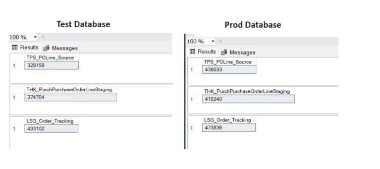

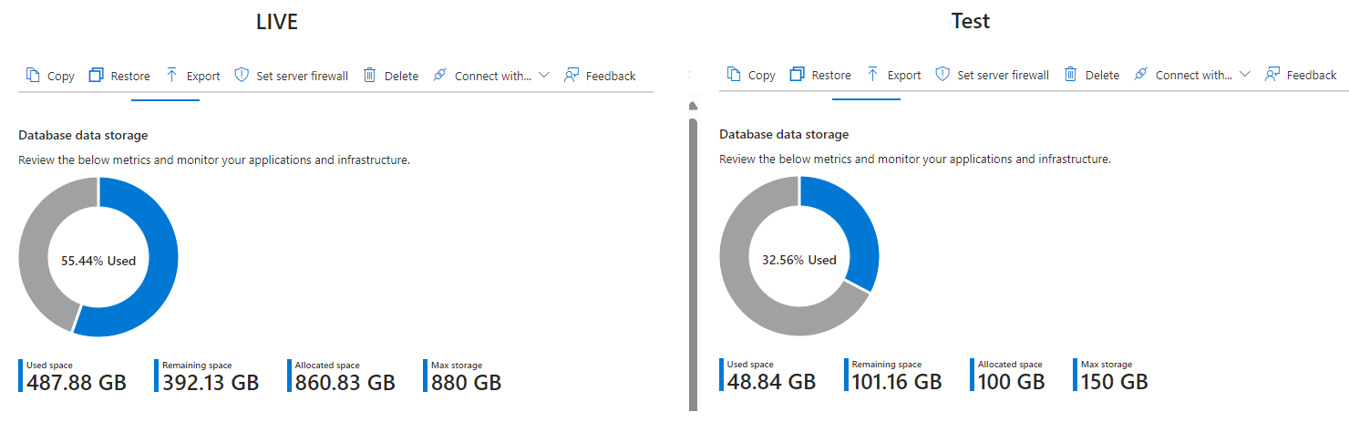

    Sorry for the delay, but here are some observations. Let me first say that even with actual execution plans it is not always possible to say things with certainty. Having the table and index definitions could help more, but it is still a handicap not having access to the actual data. And for that matter not knowing the business rules.
    Anyway, the original question was why there is a performance difference between Prod and Test. The answer is the amount of data is not the same. It is approximately the same, but the difference is big enough to result in a plan difference. More precisely, the difference is in this part of the query:
    from TPS_POLine_Source tl
                  inner join dbo.THK_PurchPurchaseOrderLineStaging pl
                         on pl.PURCHASEORDERNUMBER = tl.PurchaseOrderNumber
                         and pl.LINENUMBER = tl.LineNumber
    In Prod this join is carried out as a Nested Loop join, whereas in test this is done with a Hash Join. An important difference is also that the Key Lookup required for THK_PurchPurchaseOrderLineStaging is before the join in Test, but after in Prod.
    So what can be done about this query? I would recommend removing the index hints in the query. I don't think they serve any purpose. It can very well be that for both THK_PurchPurchaseOrderLineStaging and LSG_Order_Tracking a Clustered Index Scan is a better choice. Whether removing the hints is sufficient remains to see.
    As for the inflated estimates we discussed earlier, they seem to come from this join:
    left join dbo.LSG_Order_Tracking ot
                         on ot.POInventTransID = tl.POInventTransId
    The big estimates suggests that POInventTransID is not a key in either table. But the actual values suggests that it may in practice be. Do you have any more information about this column?
