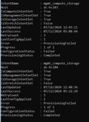

After successfully deploying Azure Stack HCI on a Cisco Validated Server for Azure Stack HCI, the Net Intent provisioning status is now reporting "ProvisioningFailed"

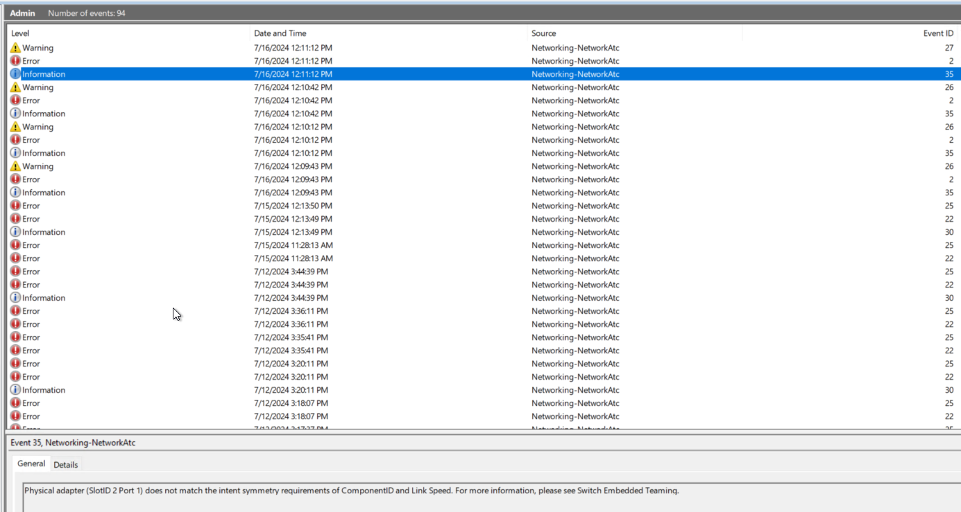

After checking Logs, I found a Network ATC Log which states:
"Network ATC failed while applying the intent (FabricManager.AtcException
at FabricManager.FabricHelperFacade.ValidateNetworkAdapterSymmetry(String displayName, NetAdapterSymmetry symmetryInfo)). Please refer to the service traces for details on the failure. Exception : () "

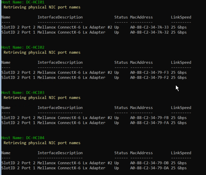

It leads to believe that the symmetry has gone between the network adapters. However when I check this, the network adapter Name, Description, Speed is all the same.
RoyalTS_5hOZpfJnVC
RoyalTS_nq18Hu7Dr7
RoyalTS_wsUxbdSm2y

    What driver version have you installed?
    If you are using the inbox drivers you need to update them to the latest that Cisco and Mellanox support for Azure Stack HCI.
    Get-NetAdapter | ft name,Speed,ComponentID,interfacedescription
    Make sure the componentid of the adapters that will be attached to the same vswitch are identical.
    Hope this helps resolve the issue.
