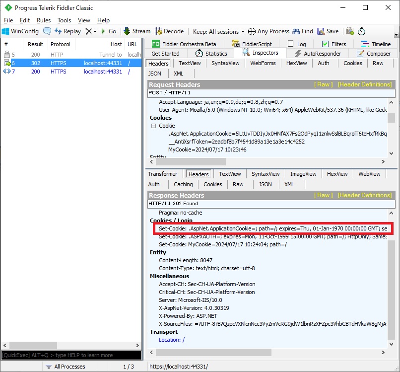

    Logout
    The response header includes the authentication cookie with expires=Thu, 01-Jan-1970 00:00:00:
    enter image description here

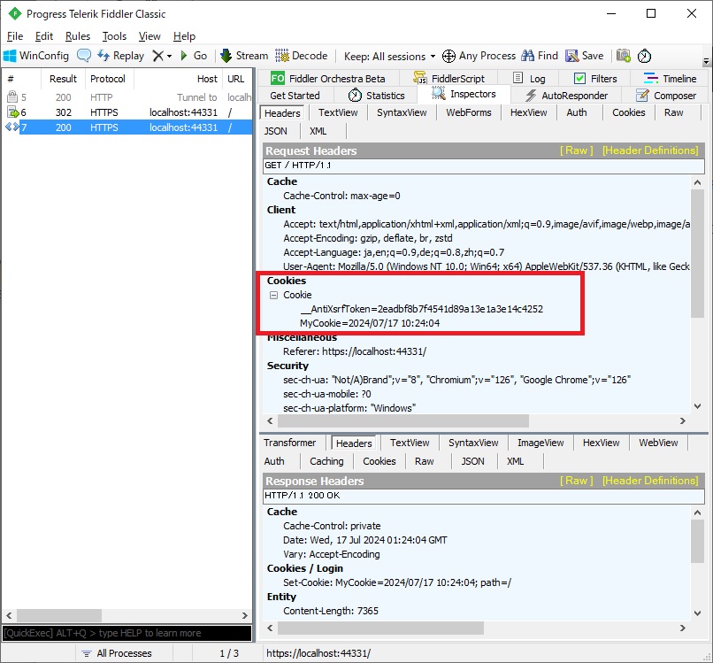

    Redirect
    When browser requests the url shown as the Location according to HTTP 302 response above, the authentication cookie will be deleted by the bowser and will not be sent to the server:
