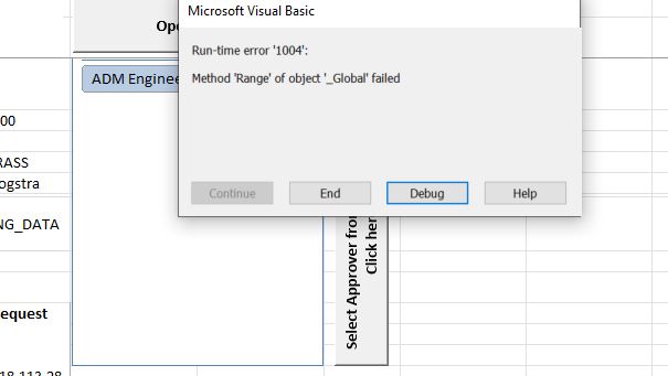

We recently migrated to O365 and we have several spreadsheets that are legacy items that transpose information from one sheet to another (info from input sheet to a table that is on another sheet for upload and is reconfigured to a different format) .
Up until last week all of them were working for everyone perfectly but now named ranges are causing this error message for some users but not all which seems odd. To our knowledge nothing was updated last week other than we did a server restart.
We have reviewed Macro security codes to align the users having trouble with the ones that are not having trouble. This has not made a difference unless there are other macro alignments not directly in excel that need to be done. The error message and code that it is getting stuck on is below:SnipImage (002)

The other ranges are not causing an issue just the one bolded above relating to named code "Rev" in the same workbook which throws the error message.  The value of this range is "0" in most cases but it can have a value if a revision occurs on an existing document.
Compared to the expertise online, I understand VBA and have problem solved successfully before but this does not seem to be consistent other than some ranges don't work for some users on some spreadsheets so any help with the debugging of this would be appreciated!
Thanks in advance for your review of this item.  JF
