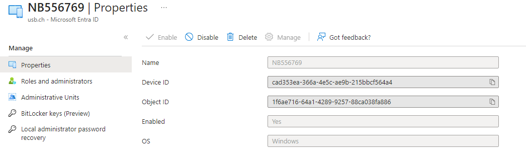

Device-ID in Entra ID:
cad353ea-366a-4e5c-ae9b-215bbcf564a4

As you can see in the output from "dsregcmd /status" the join fails because the device tries to join with the ID from local Active Directory and cannot find a Device in Entra ID with this ID. When searching for my device in Entra ID i can find it with another Device-ID.
Does anyone have the same issues?
I tried deleted the object in Entra ID and hoped it will be resynced from lokal AD with the correct ID but the object was created in Entra ID with another ID then in local AD. Can someone assist?
