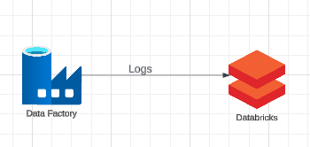

Good morning,
I need assistance in creating a project that captures logs from Azure Data Factory and inserts them into a Delta Table in Databricks. The key requirements for this project are as follows:
  1. No Duplicate Logs: Ensuring that the logs are not duplicated.
  2. Pre-Established Schema: The logs must follow a pre-established schema for the Delta Table.
  3. Trigger-Based Ingestion: The process should be triggered automatically whenever a pipeline run occurs in Data Factory. This means that the log is generated and immediately sent to Databricks for future monitoring purposes.
  4. Mandatory Storage in Databricks: The logs must be stored in Databricks for compliance and monitoring.
Could you please suggest a cost-effective, efficient, and scalable solution to achieve this?
Thank you!

    A combination of Azure Data Factory, Azure Event Hubs, and Azure Databricks can efficiently meet these requirements.
    1. Azure Data Factory:
      • Configure pipeline runs to generate logs in a specific format.
      • Trigger an event to Azure Event Hubs on pipeline completion.
    2. Azure Event Hubs:
      • Capture events from Azure Data Factory.
      • Provide a scalable, fault-tolerant, and high-throughput platform for ingesting data.
    3. Azure Databricks:
      • Consume events from Event Hubs using a Databricks notebook or job.
      • Transform and enrich data according to the pre-established schema.
      • Insert data into the Delta Table.
    key Considerations
    Event Hubs:
    • Use a capture endpoint to store events for replay or later consumption.
    • Configure retention policy to balance cost and data availability.
    • Implement error handling and retry logic for reliable data ingestion.
    Databricks:
    • Create a Delta Table with the required schema.
    • Develop a Spark job or notebook to consume events from Event Hubs.
    • Use structured streaming to handle continuous data ingestion.
    • Implement deduplication logic based on a unique identifier in the log data.
    • Leverage Delta Lake's ACID properties for data consistency and reliability.
    Triggering:
    • Utilize Azure Data Factory's event-based triggers to initiate pipeline runs.
    • Consider using Azure Logic Apps for more complex orchestration scenarios.
    Here’s a more detailed breakdown:
    No Duplicate Logs: To ensure no duplicate logs, you can make use of the RunId of the ADF pipeline run. This RunId is unique for each pipeline run and can be used as a primary key in your Delta table.
    Pre-Established Schema: The logs from ADF will follow a pre-defined schema. You can define the schema for the Delta table to match this log schema.
    Trigger-Based Ingestion: ADF can be configured to send events to Azure Event Hubs whenever a pipeline run occurs. This event can be used to trigger a Databricks job that will ingest the log into a Delta table.
    Mandatory Storage in Databricks: The Databricks job will ingest the log data into a Delta table. Delta tables in Databricks provide ACID transactions, scalable metadata handling, and unifies streaming and batch data processing.
    Cost Optimization:
    • Adjust Event Hubs throughput units based on expected event volume.
    • Optimize Databricks cluster size and auto-scaling settings.
    • Explore cost-effective storage options for Delta Lake data.
    Hope this helps. Do let us know if you any further queries.
