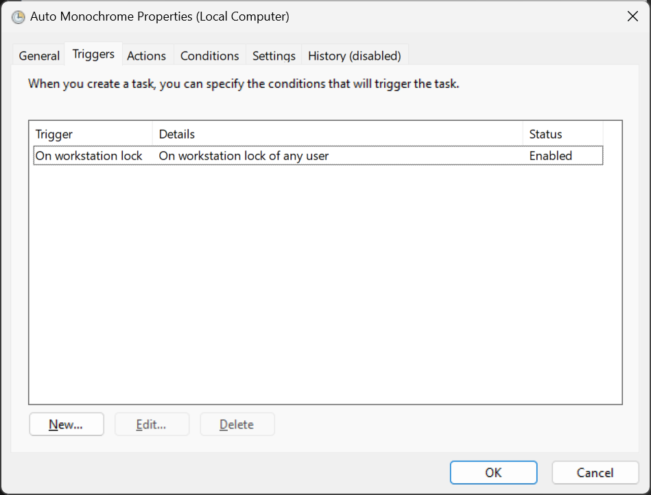

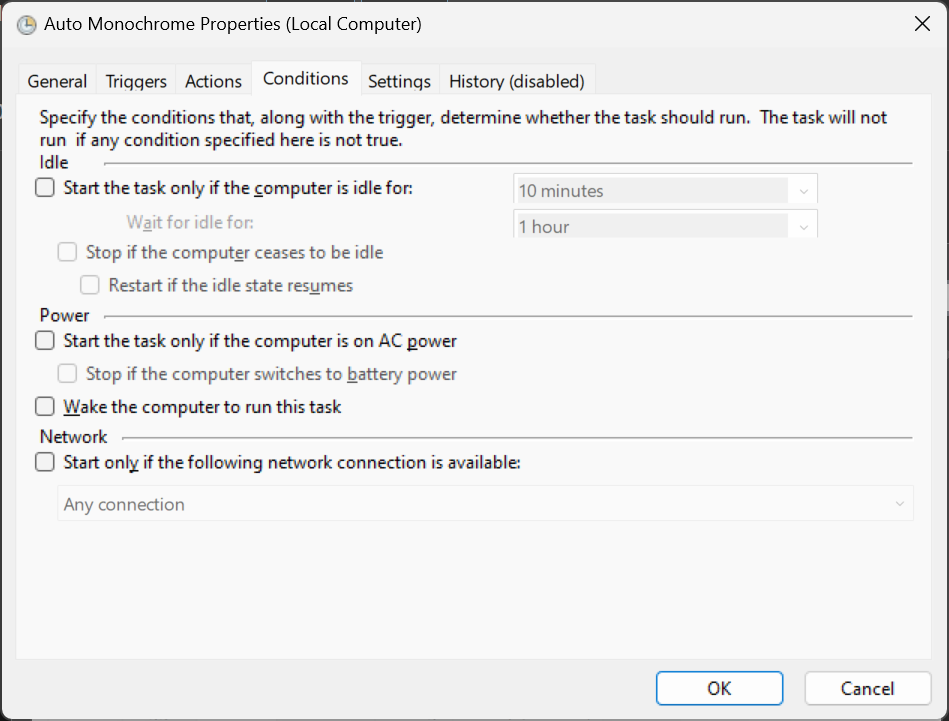

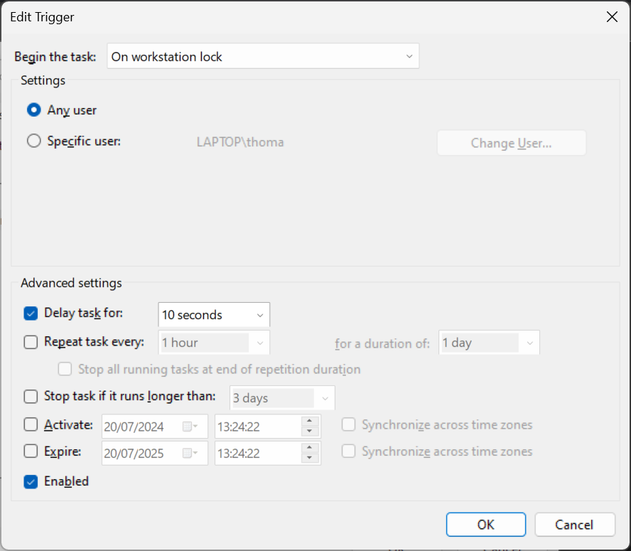

So I have been trying to set up Task Scheduler to run an Autohotkey .ahk script that toggles to Monochrome mode by sending Windows+Control+C.
However the task that I have created does not seem to run the script.
I have run the script manually (by double clicking) and it works, so it can only be the Task Scheduler, or how I am linking the script to the task.
I have included a screenshot of all the different settings as well as the autohotkey script.

  1. MotoX80 36,401 Reputation points
    2024-07-19T00:46:26.98+00:00
    Set the task to "Run only when user is logged on."
    Here is a post that describes how to run an AutoHotKey script with the task scheduler.
    https://www.autohotkey.com/boards/viewtopic.php?t=97762
    Since this process is running at user logon time, there may be other programs initializing that could affect it. In "Advanced settings", you may need to play around with setting the "Delay task for" timeframe to allow other apps time to run.
    What is "Cold Turkey Blocker" and what does that have to do with running an Autohotkey script? Your task needs to run the Autohotkey executable and pass it the file name of your script as an argument.
