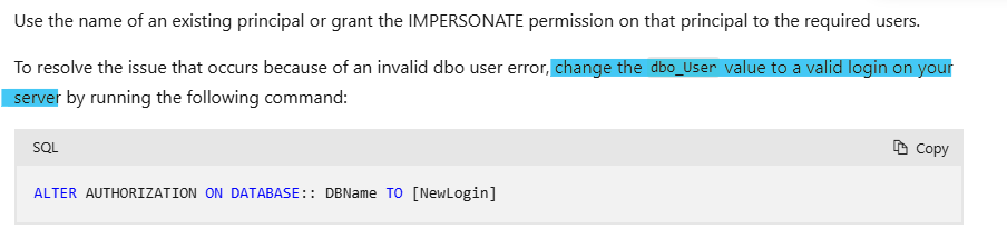

    Hi Stephen Keogh,
    As per message, it is clear that something is not right with database principal dbo. What actions did you do? Is this database obtained by restoring?
    You can refer to this official document, it can help you understand well.
    Please notice that this login should be added to the sysadmin role.
    In addition, please check it out and show us the results of it returns:
