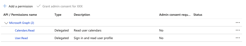

I have an App Registration that has two API permissions. I want to use this permission to access some information about the user in my apps.

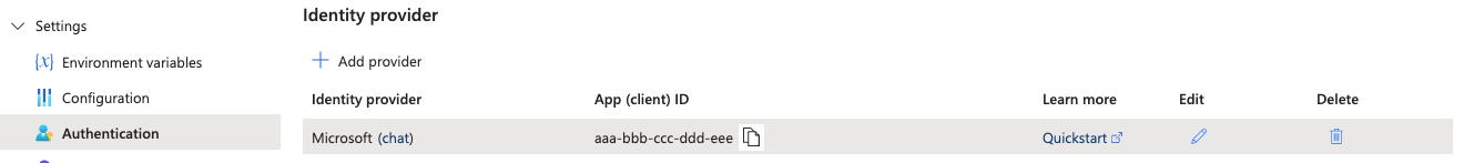

I have already integrated this app registration into my web apps in Azure Portal. I am adding this in the Authentication section on the Web Apps page.

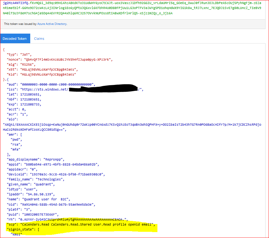

User's image But the problem is I still can't use the access token from the Authentication to get the information based on the permission that I already created before. I have checked the access token in https://jwt.ms/, but the scope is still not updated.

    From your screenshot, "Calendars.Read" and "User.Read" are delegated permissions. These are user permissions that require a logged-in user to receive delegated permissions in the OAuth 2.0 authorization code flow.

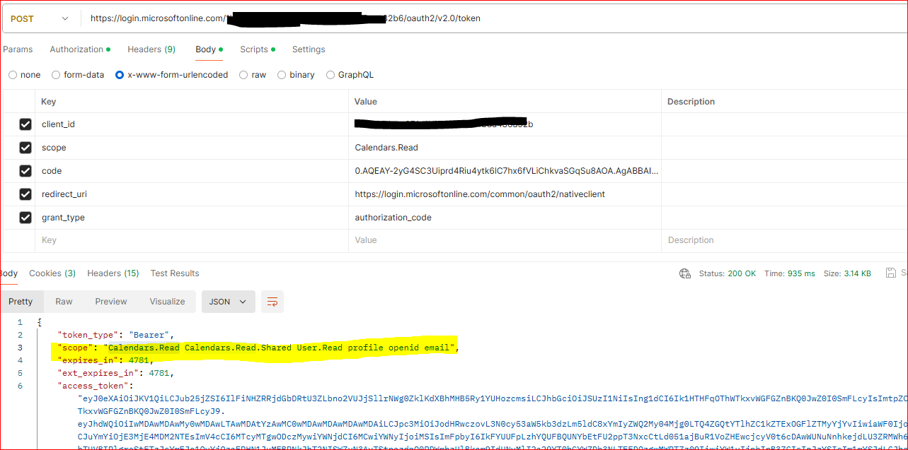

    Request an access token.User's image
    Checked in jwt.ms Successfully obtained Calendars. Read scope in the access token.
