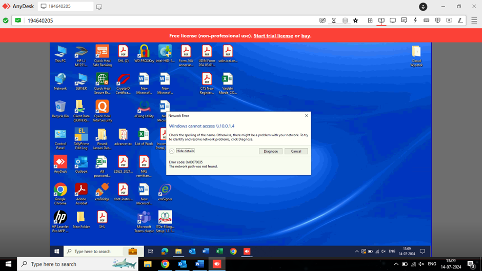

I have enabled Point-to-Site connectivity to a virtual network in my Azure environment. I am able to remotely connect to the VPN tunnel and can ping the private address of the Azure virtual machine. I can also RDP into the server. The problem is that I am not able to access file shares. On this virtual network we also have a site-to-site vpn up so that the office can access the server. The site-to-site is working fine. The users can access the shared folders, query DNS, and authenticate against AD. Does anyone have any idea why ICMP and RDP would work over the point-to-site VPN but file share browsing would not? I have confirmed that DNS is resolving correctly.
i am not able to access files on cloud using wifi after connected azure vpn point to site
if i use office network i am able to access files folder on the cloud
