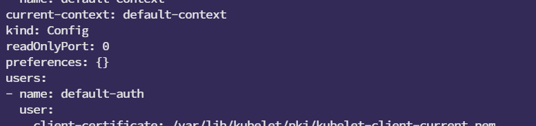

opened /var/lib/kubelet/kubeconfig
added readOnlyPort: 0
save and exit

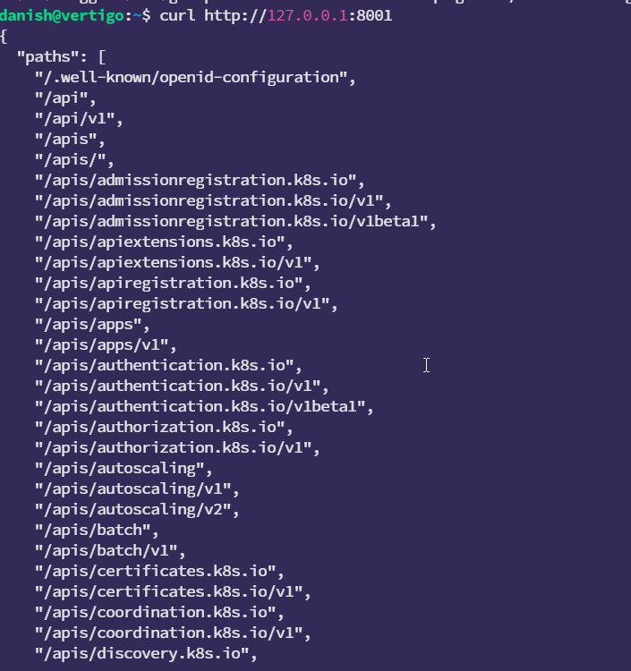

How we tested
kubectl proxy
curl http://127.0.0.1:8001
Even after all the config changes above the curl command returned all the information that it should not.

    As AKS is a managed service, you don't have access to modify the master nodes. The changes you've attempted on the master nodes likely didn't take effect due to this.
    The kubectl proxyproxies requests to the Kubernetes API server not kubelet API.
    You can test this out to disable:
    az aks update --resource-group <RG> --name <Cluster> --set agentPoolProfiles[0].kubeletConfig.readOnlyPort=0
    You can also try custom Kubelet config
    https://learn.microsoft.com/en-us/azure/aks/custom-node-configuration?tabs=linux-node-pools
    If this does not work, I will recommend opening a support case for dedicated assistance.
