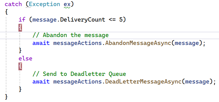

I implemented something like in catch block of function we are abandoning the message 5 times and in case of >5 retries, I'm deadlettering the message.
Here this retry is not controlled. I want to retry at exponential interval. How I can achieve that?

    I understand that you would like to implement controlled exponential retries if the function fails due to connectivity issues with the API, with the situation at hand you have abandons the message up to 5 times and then deadletters it if retries exceed 5, but this approach lacks controlled exponential retry intervals.
