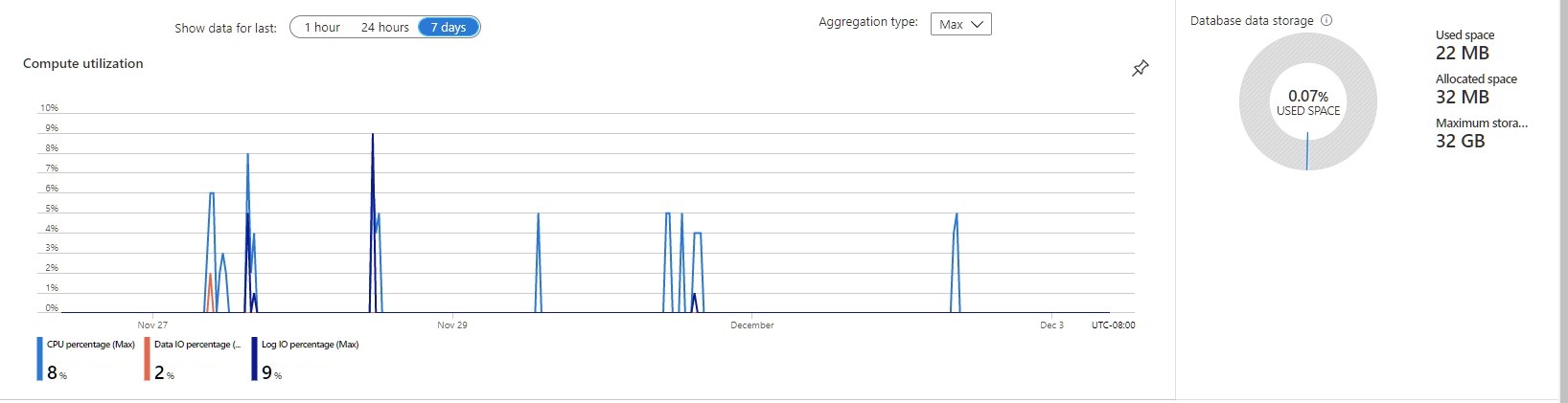

  1. Anurag Sharma 17,636 Reputation points
    2020-12-03T08:33:07.103+00:00
    Hi @Chinook_pdx , welcome to Microsoft Q&A forum.
    This could be because of multiple reasons related to connectivity but you mentioned it worked for small portion of data. So it could be related to usage limit of Azure SQL database too.
    Just for testing purpose, can you please increase the compute size of the database and run the code again?
    If it still does not work, we can look into below thread where retry logic is being used for similar error:
    https://stackoverflow.com/questions/41473137/pyodbc-how-to-retry-to-recover-from-transient-errors
    Please let me know once you try these changes.

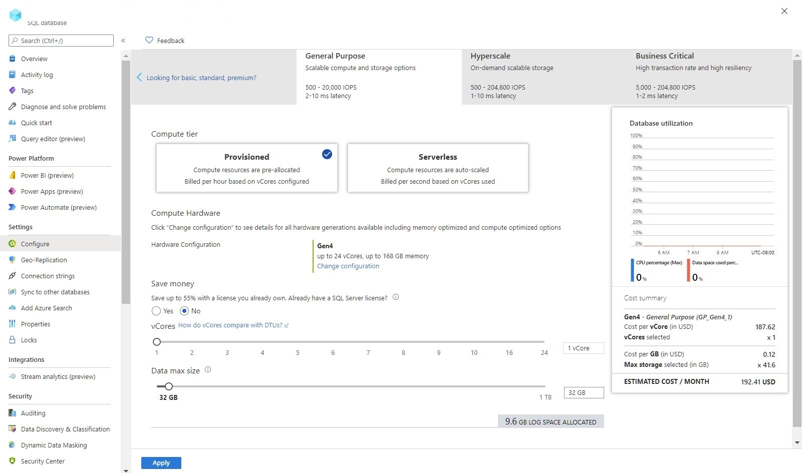

  2. Chinook_pdx 106 Reputation points
    2020-12-03T18:14:02.513+00:00
    Hi @AnuragSharma-MSFT,
    Thanks for your response. I posted the Compute Utilization and our current Hardware Configuration below. Please let me know what shall I set the Compute Size of the database to?
    Thanks.
